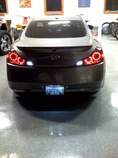

pictures of my LED reverse lights...
Old Mar 9, 2008 | 05:40 AM
  #41
UNV-IT46's Avatar
UNV-IT46
Posts: 3,985
From: SoFlo
very nice... did you replace all the tail light items that were not reusable or just say **** it?
Old Mar 9, 2008 | 01:15 PM
  #42
delfin2003's Avatar
delfin2003
Joined: Jan 2008
Posts: 108
lol, nice, looks like ppl starting to join the 'LED' club. You don't have to replace them, they are just fine. Its basically little sponge pieces, and they never tore when I worked on my lights.
