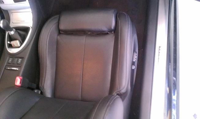

The black leather of my 08G37S coupe didn't look that great. It was shiny and some areas where "cardboard" hard. I read a lot about caring for our leather, and found out the leather is coated, therefore in order to properly clean it, we can't just use the 'usual' leather oils, conditioners, and cleaners that are used on older leather that isn't coated. I asked a friend of mine that has some experience on auto detailing and said to me he uses Leatherique on all the cars he details, even on the ones that have the coated-leather with the same impressive results.
Before you go any further, I'd like to point out that I am in no way promoting, or advertising this product. It's just what I used and what worked for me.

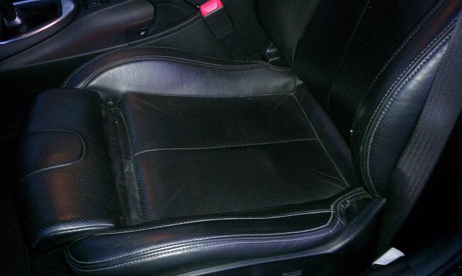

Let's get started then. This is what my seats used to look like:

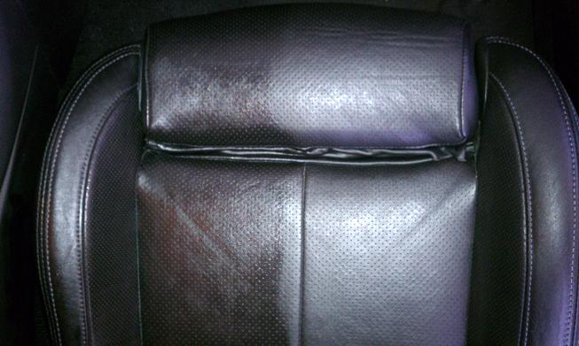

After applying what they call "leather rejuvenator" they recommend you leave the car with the windows up and in the sun to create a sauna effect inside the vehicle, this is to allow the product to soak in, penetrate in the leather and force out the dirt and contaminants. They recommend to let it sit for several hours to a day, I left mine out in the sun for a day and moved on to the next step the morning after.
I wiped down only the right side on this picture so you can see the huge difference...
I used the brush that came with the kit to remove all that dirt buildup:

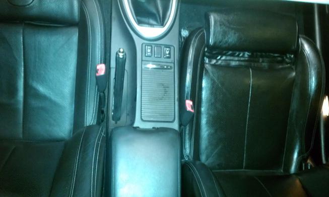

Took this pic from above the sunroof, it shows the driver's side seat all done, compared to the passenger's side with the rejuvenator still on it with all the dirt it pulled from the seat... (don't worry if you spill some of the product on your plastic areas, I inadvertently had spilled some on my center console, and it wiped right off next day...)

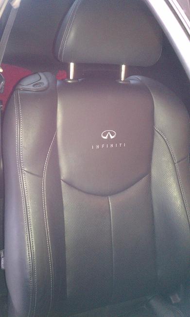

And the final result.
I will do a second application maybe next week, I still see some spots that need to be looked at. Imagine 4 years of dirt, contaminants, sun, and on top of that, my car was a lease for a while before I bought it, and the leaser was a smoker... (I had to wash the carpet and now that the leather is treated, the smell is gone!)
As a final touch, and to add protection to it, I used 303 on them, and wiped down the excess with MF.
Hope you found this article helpful.
The leather in my G37S has been reloaded!

For some reason my pics didn't load at first. Thanks Black Betty! Got them to work now.

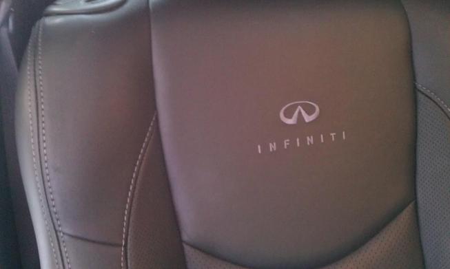

Infiniti and Mt. Fuji's stitching look new, also the leather looks soft, it also feels that way!

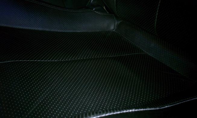

And to think the inside of my car looked like this...
