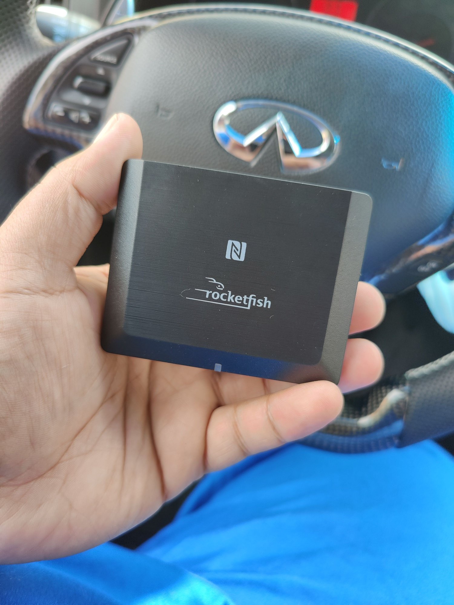

So after some research, I found a nice powered bluetooth receiver, that had Qualcomm HD output and it was roughly 50 bucks! I rather the HD output for obvious reasons, but was really surprised by how much better it sounded than standard youtube.
Rocketfish Unit RF-BTR319

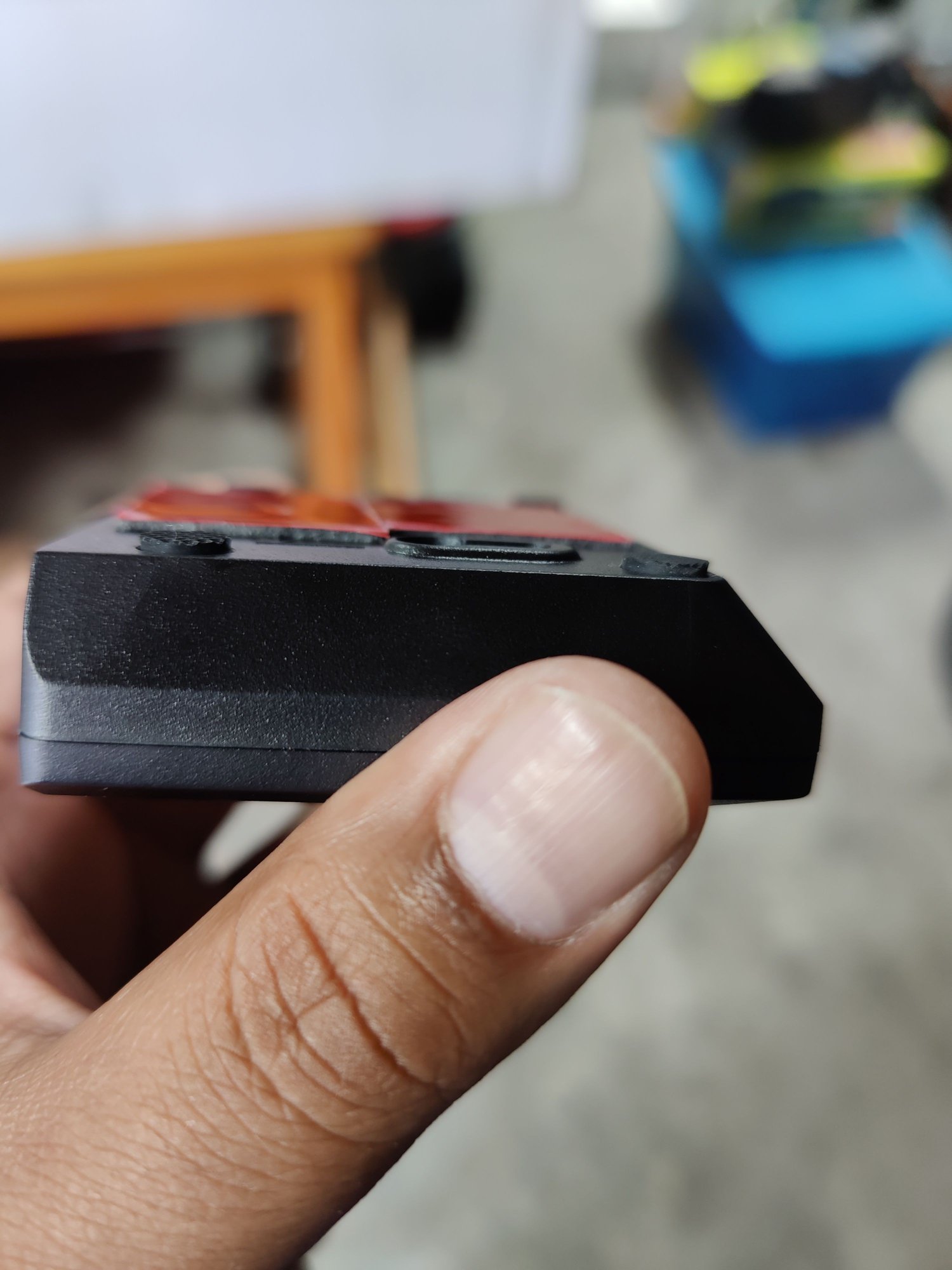

Make sure you switch on Qualcomm

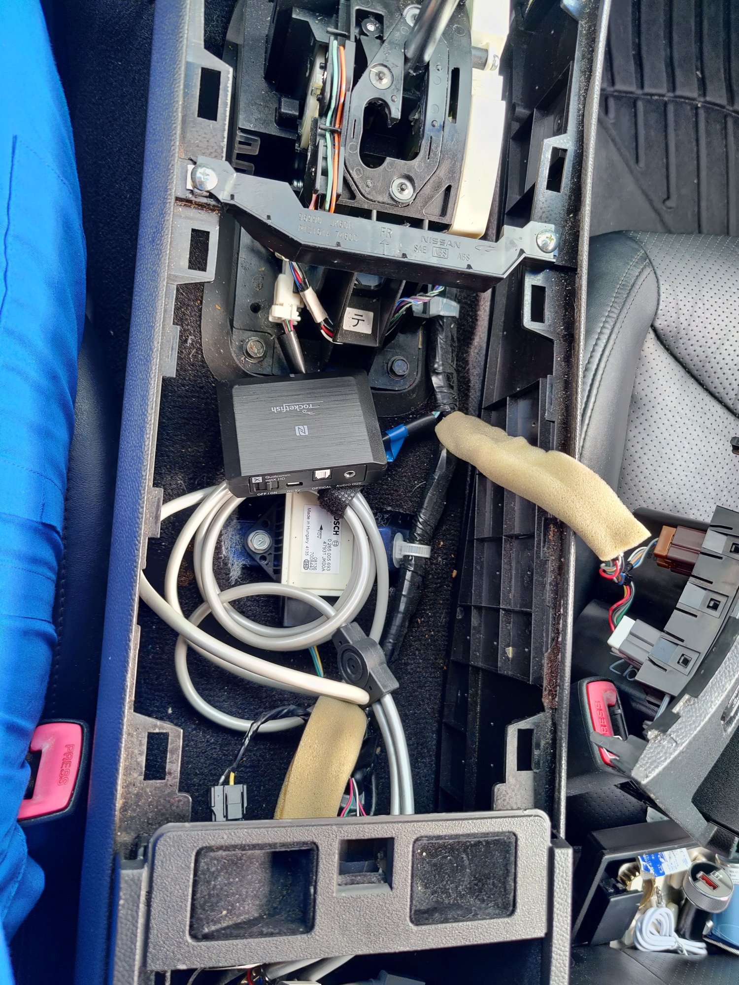

Now disassemble the center console.... Excuse my mess...
Instead of drilling holes, I chose to remove my Apple Plug. 2 tabs on each side, squeeze them in and use some gentle persuasion to get them out.
I thought about removing the core by drilling it out, as to give it a more clean finish when installing but, I decided to just re attach to the connector and keep it hidden under the console. As u noticed, my tabs are gouged. I fit matters how it looks, use a plastic trim tool...
Lots of room for dem cables... Slide them on in...
Because its a powered unit, I went ahead and used my Anker, double usb charger that supports Qi charging. Its more than enough to power the receiver, and will power my Scosche Unit once I figure out how to mount that properly...cause you know...G37 dashboards be melting...
Lots of room for cables, but this is anxiety for me. Cable mgmt is a must. At this point you chould check to make sure everything is working (radio etc...)
Looking for a suitable mounting space, there is enough space on the inside panels on either side of the shifter right where it meets with the cup holder trim. It also allows for it to be mounted flushly without any clearance issues. I chose the driver side as it was a little bit roomier...
Using some double sided 3m tape, i cut 2 strips of 1in thickness and put them between the rubber pads and wall mount holes. I kept the rubber pads on as it was at the same height with the tape and it would help with any vibrations.
Cable mgmt done!. Wires coiled and tucked neatly, BT Receiver firmly in place. Retest one more time before putting it all back. Also, if in there is dirty, nows a good time to do some cleanup!
Nice and clutter free from a bulky unit and coiled wires...
Should have put the tray on the first slot, to show cubby hole depth...
So thats it basically. Shouldnt take you more than 30 minutes or. so. Quick, Simple and Straightforward for anyone looking to add a little more functionality to their G... As they say, on to the next one...
