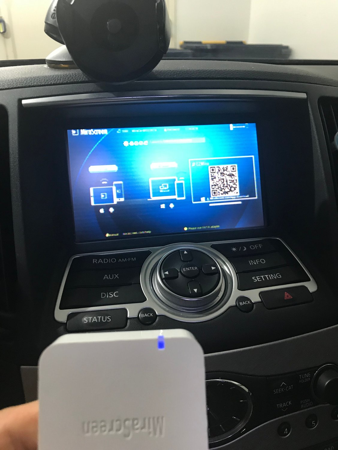

Miracast review
Received and installed miracast today. It works as intended - as you can see from the pics, I took a video but cannot upload here - but overall the results were kind of underwhelming. Resolution is not the greatest, it does not work with Netflix, and there was very minor distortion with my mine (could be due to the power supply?) 4 out of 10. What was good - it does stream music via Spotify even with screen off, maps was okay - little blurry and a little distortion, you tube works. Is it worth it? Meh I don’t see how it is better than my phone tbh - I have a stand on my dash and the resolution is better. If you see the uneven horizontal lines that is the distortion I speak of, honestly phone mirroring is not as cool as I thought it would be.... maybe I’ll mess around with maps and see if I like it for that - it does work via hdmi and when hooked up to a tv there is no distortion
below are screen captures of the original video so the home screen does look like it would on your phone, just a little blurry
Taking video with phone mirroring
Bad pic of my iPhone home screen

screen mirroring?
how it shows after connecting to wi-fi, then choosing screen mirroring
I mean my initial review is a bit critical, mainly because I have a backup cam that and a bluetooth receiver that were using the composite connections in my car so the miracast was competing against those. The distortion is minimal most people would not care - especially with a lighter background, it does switch to full screen when you turn your phone sideways- pics posted below. I use my phone as a camera so I would like to show maps and youtube but am unable due to the "mirroring." I will test it out for a while, so far maps is useful as I can stream music at the same time and the only thing I don't like, is that it does not auto connect. So every time i want to use it I have to connect to the miracast via wi-fi settings - then choose mirror screen from the iphone (swipe up menu) - maybe i can set it to be default but that is inconvenient. If you do not have a bluetooth receiver for streaming music, I think this would be a good purchase - not sure how it will hold up to extreme temperatures but for something that costed 23 dollars I'm surprised nobody mentioned this as an option. I found some 400-600 dollar alternatives but it seemed ridiculous for what you were getting. Let me know if you have any other questions -
what comes in the box
configuration screen
screen mirroring - landscape
screen mirroring - portrait mode
