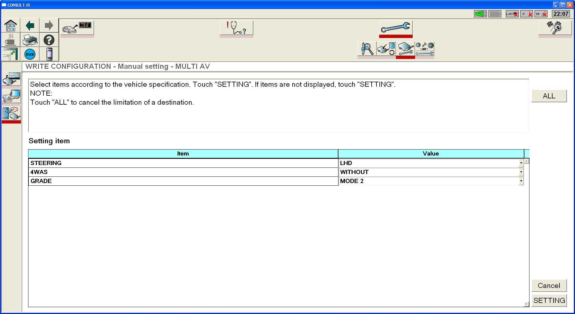

This is the consult 3 menu used to write configurations that solve your problem:

If the dealer play stupid and refuse to write the configuration, show them this picture.
Any Nissan technician with some decent knowledge will know the software from this picture.
