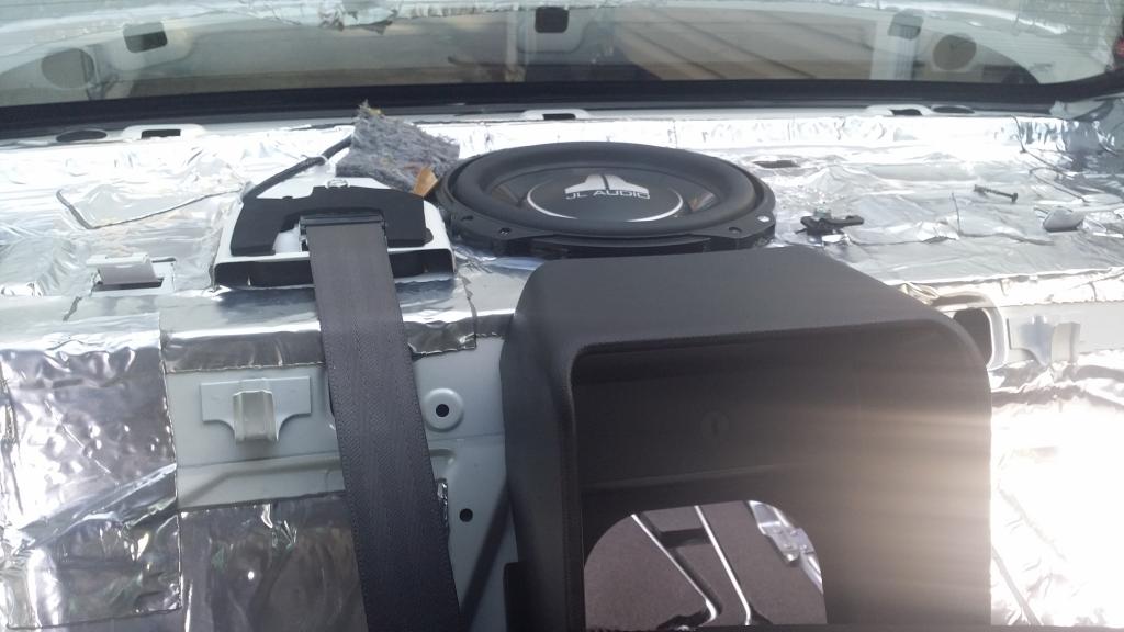

A 12" Type R will not fit. Actually, I don't think that any 12" will fit. I tried a free air install with a JL 10tw3-d4 shallow mount sub. It did fit (although it was a tight squeeze), and it actually sounded a lot better than I had expected. I loved it because the install was basically stealth apart from the amp. The problem with this install was that the deck couldn't handle the increased bass. Low volume sounded ok, but once I turned it up, it seemed like EVERYTHING back there was rattling & vibrating. Two of the biggest offenders were the seat belt housings. I applied as much dampening as I could to everything, but at the end of the day the deck was just flexing way too much for me to enjoy the sound. I ended up going the box route.
If you really want to try this type of install, I'd recommend reinforcing the rear deck with some MDF, and using a bunch of sound dampening. Will be a lot more work, but worth it so that the noises won't drive you insane.
