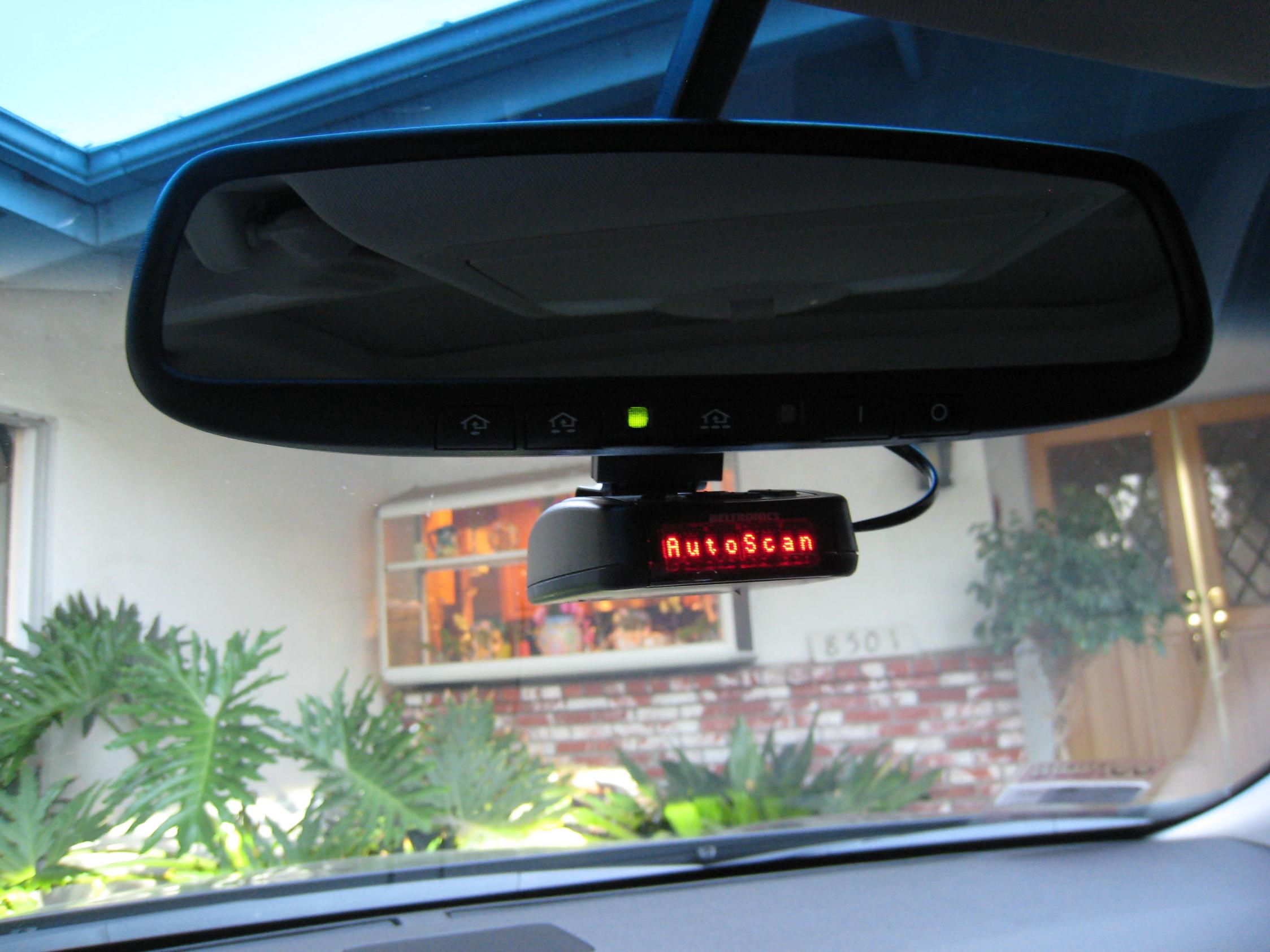

Here's mine

Originally Posted by GeezerB
Here's mine
looks good! just what I like to have. that's what I ordered. Just need to make sure when the cord comes in it has the smaller prongs.

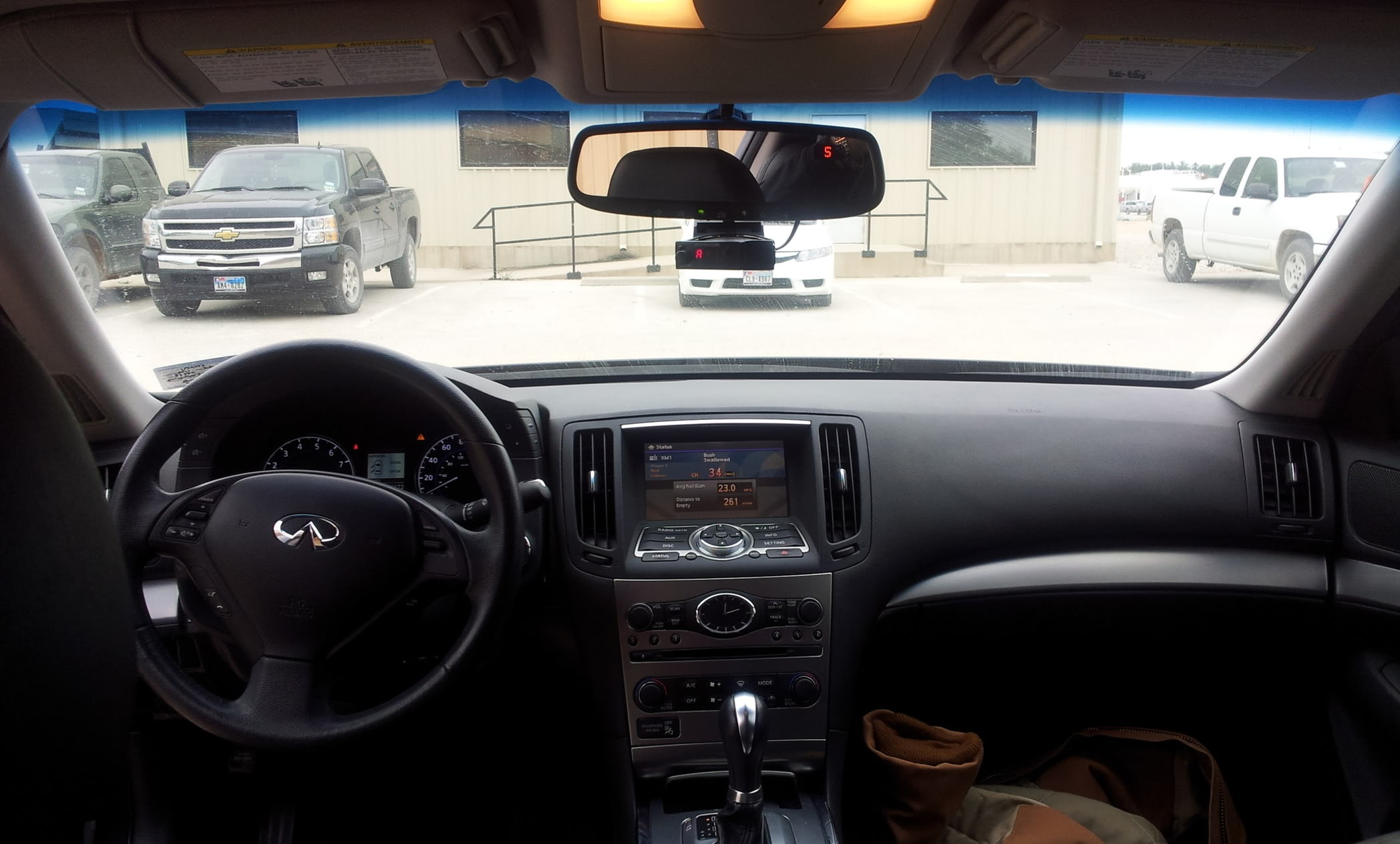

Here is my cheap ebay mount (under $30) and cheap $10 inviscord want to be with my V1.
Never had any issue. Screws have stayed tight.
