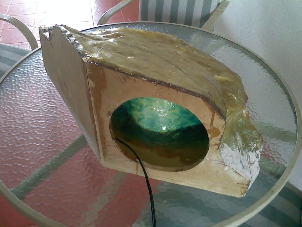

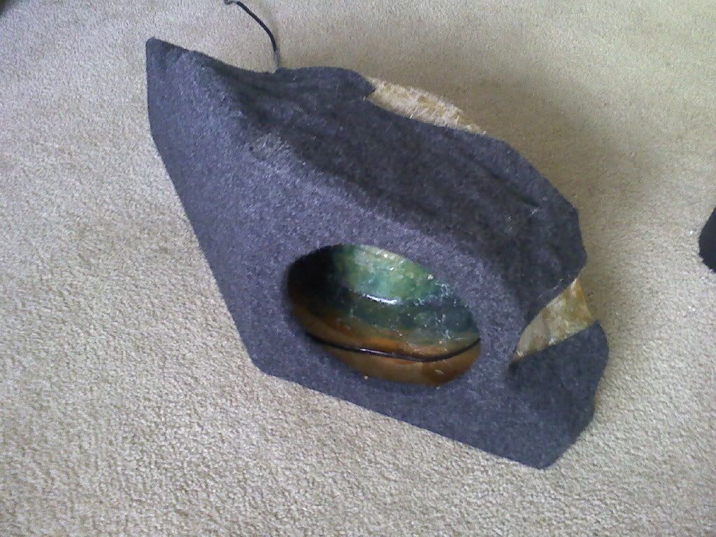

i didnt want to loose the ability to put long items through my trunk so i built a fiberglass and MDF single enclosure and just thought i'd share some pics of it sees how many people seem to have only the deep trunk boxes. its exactly one cubic foot

i used the side panel by taking it out, putting a tarp over it and taping the outside of it to the wooden framing. then i laid the fiberglass on the inside of right, through the speaker hole.
