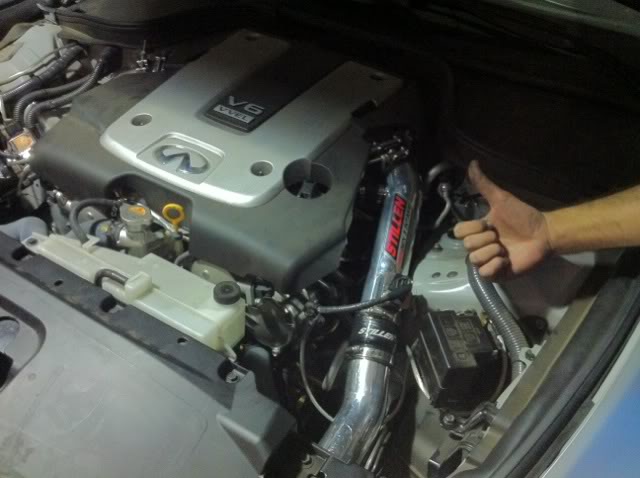

installed:

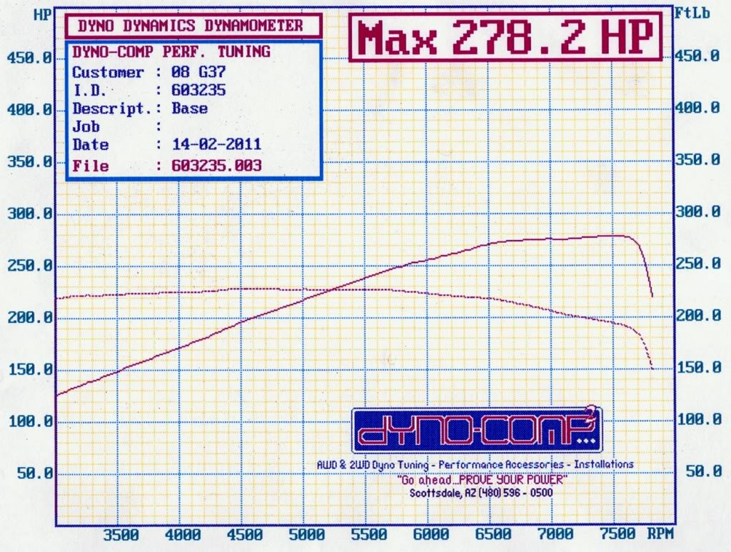

Base Dyno:

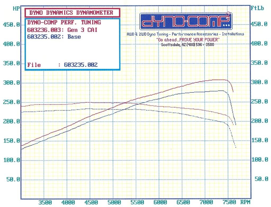

Comparison: stock vs. intake:

awesome info. I just installed mine today. I was expecting to have a lot of trub but it was pretty easy

...still 29.6 hp from an intake is really hard to swallow. the median gains from the stillen are from 12-18 from G37s and 370s...of course it doesn't reallay matter what the number is, he has his delta and gains across the curve. i guess that's what really counts. congrats

Just a quick question: how come it says under the customer line item on the dyno, 08 G37 for the base and the 09 G35 for the intakes? Is this just a weird error entered or was the base on your 08?
Just noticed that and wondered... Awesome gains though!
