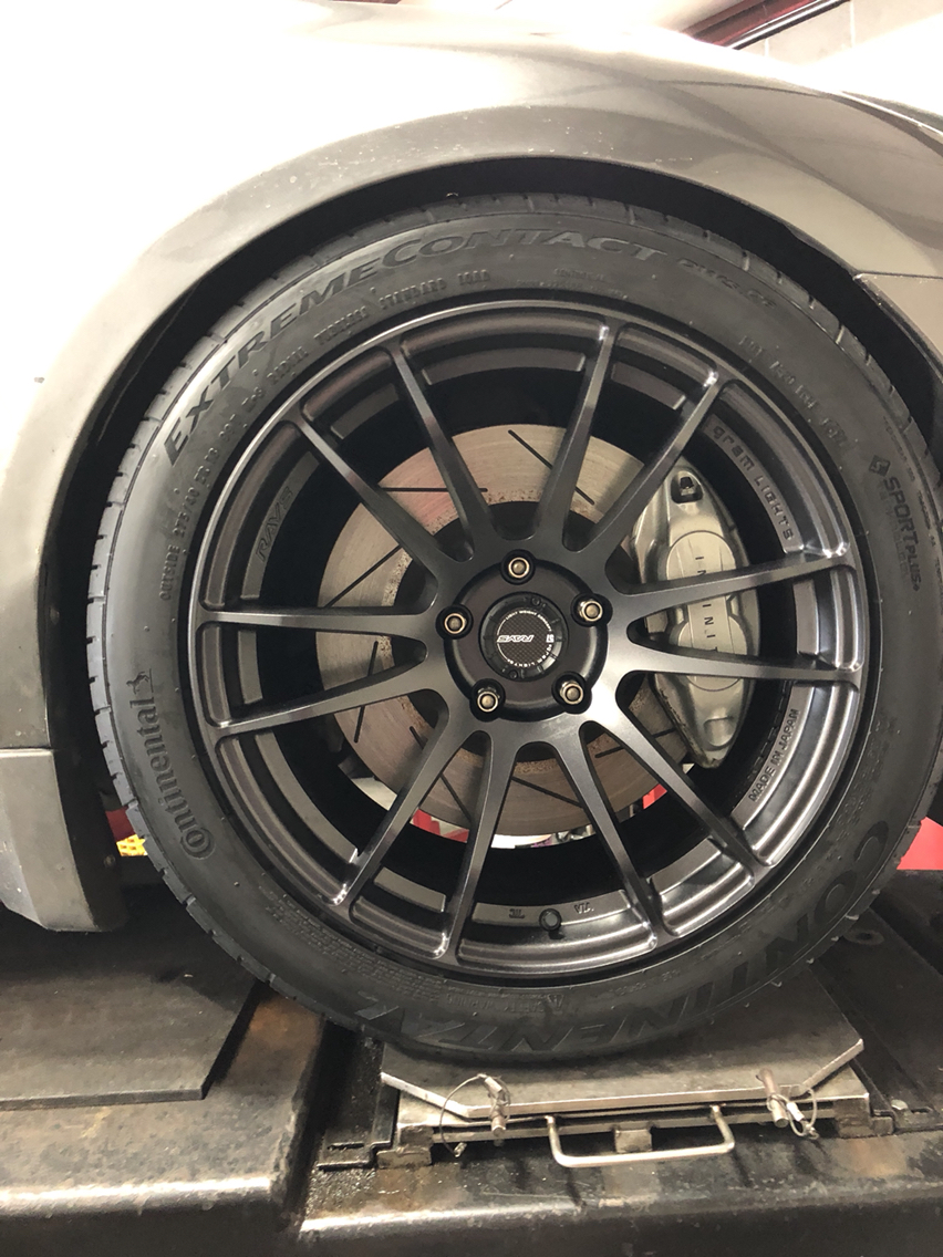

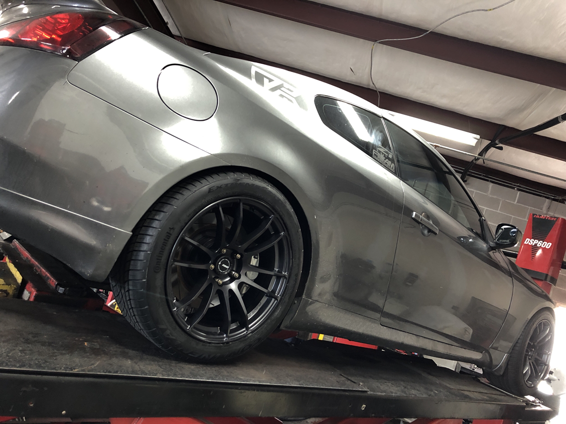

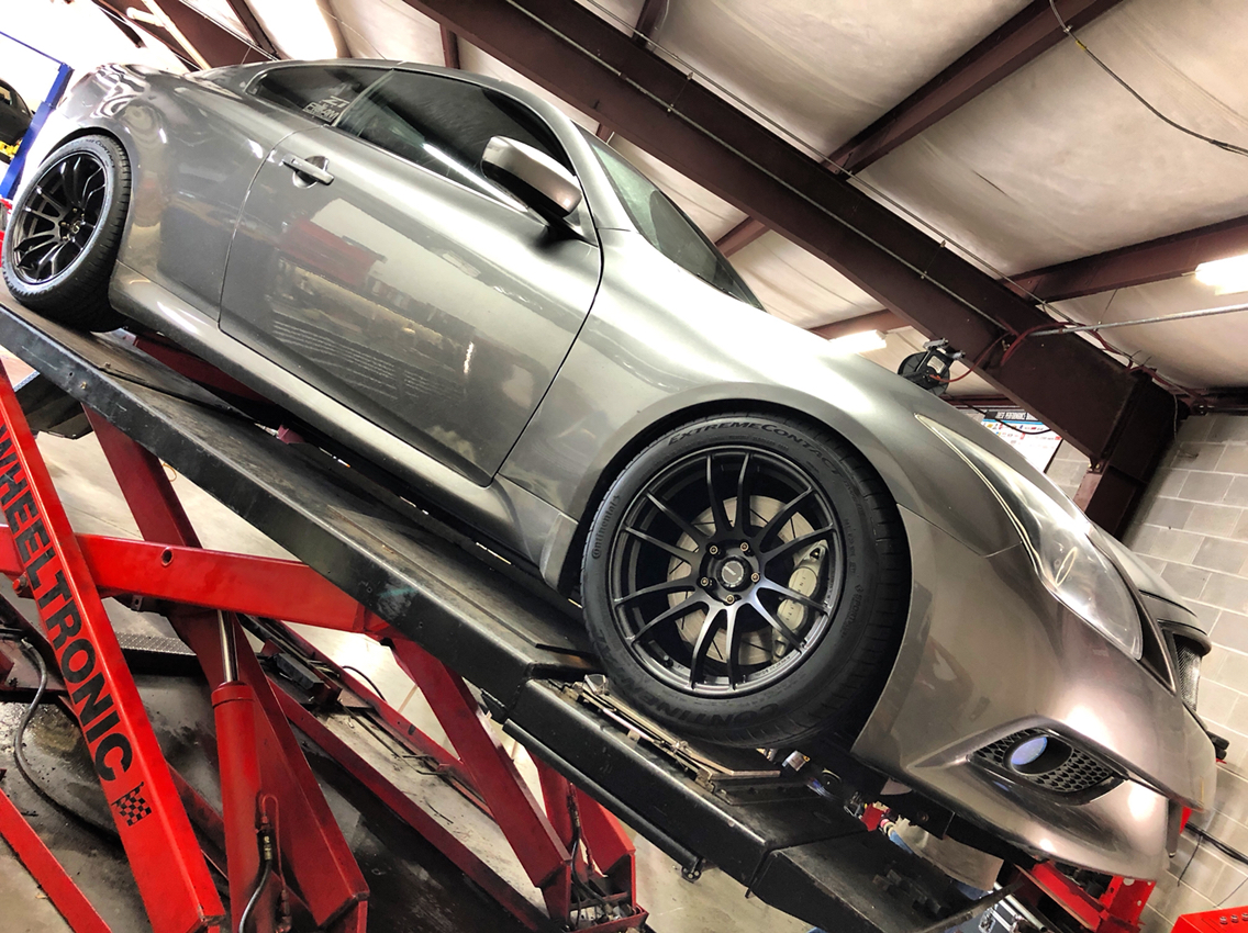

So I decided to get a new setup. Rays Gramlights 57Xtreme. They were that mag blue color but I got them repainted. Now before I start getting the haters for removing the original color, IDC. I don’t like rice! I got enough ish from my friends and told them the same lol.
18x9.5+25 square
275/40/18 Continental Extreme Contact DWS06

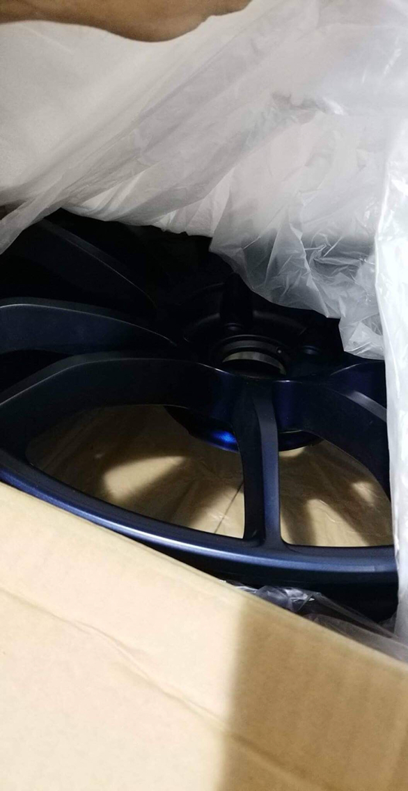

Don’t get me wrong I really didn’t want to repaint because the color was so nice. But not on my color code.
