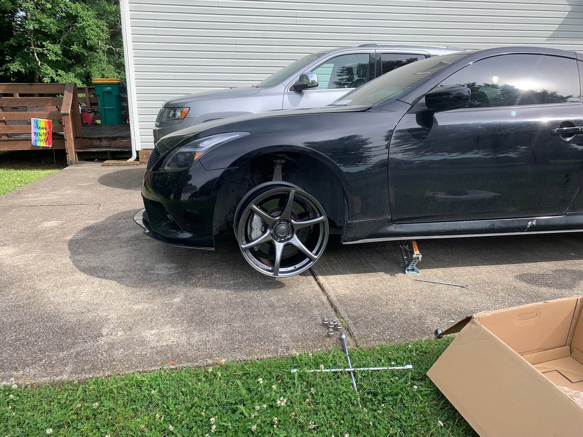

I have a 2014 AWD Q60S coupe. I purchased four 19x9.5+22 Kansei Tandems and planned to run 245/40/19 tires. When i went to Discount Tire today to get tires and have them mounted, they told me they wouldn’t fit. He told me they could put them on but couldn’t guarantee that it wouldn’t rub or make contact. In disbelief after everything I’ve seen, I took the car home, jacked it up, and put one of the wheels on. It looks like they definitely would’ve fit fine, but my problem is they poke out about an inch too wide. What specs should I look for to be flush with the fender, and have as little fender to wheel gap as possible? I’m on Swift springs, and have front upper control arms waiting to be put on. I’m on 19” stocks right now that came on the car.

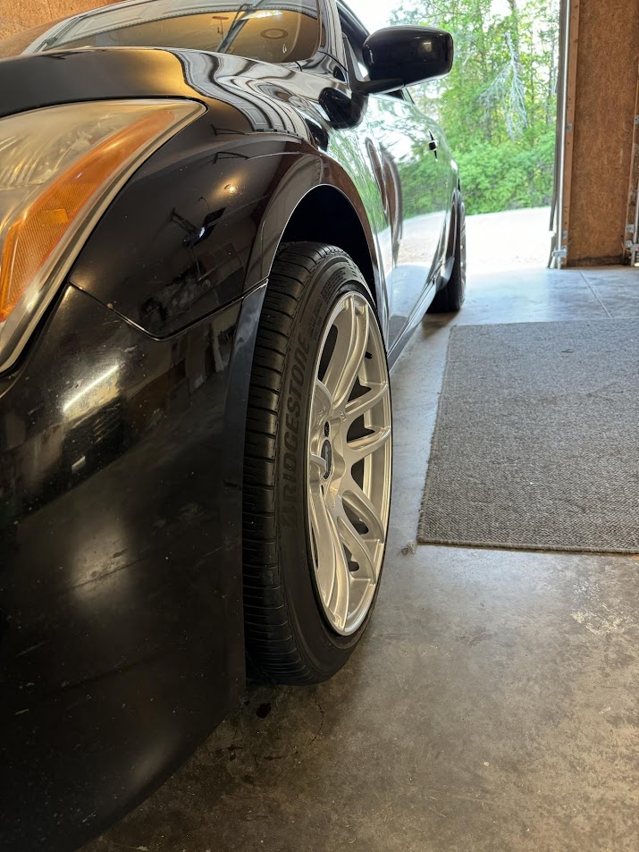

even for coupes, 9.5" +22 needs some negative camber to fit and look good.
This is the same 19x9.5 +22 with stock suspension and 245/40R19 tires, and same poke as you mentioned
This is lowered with natural camber
