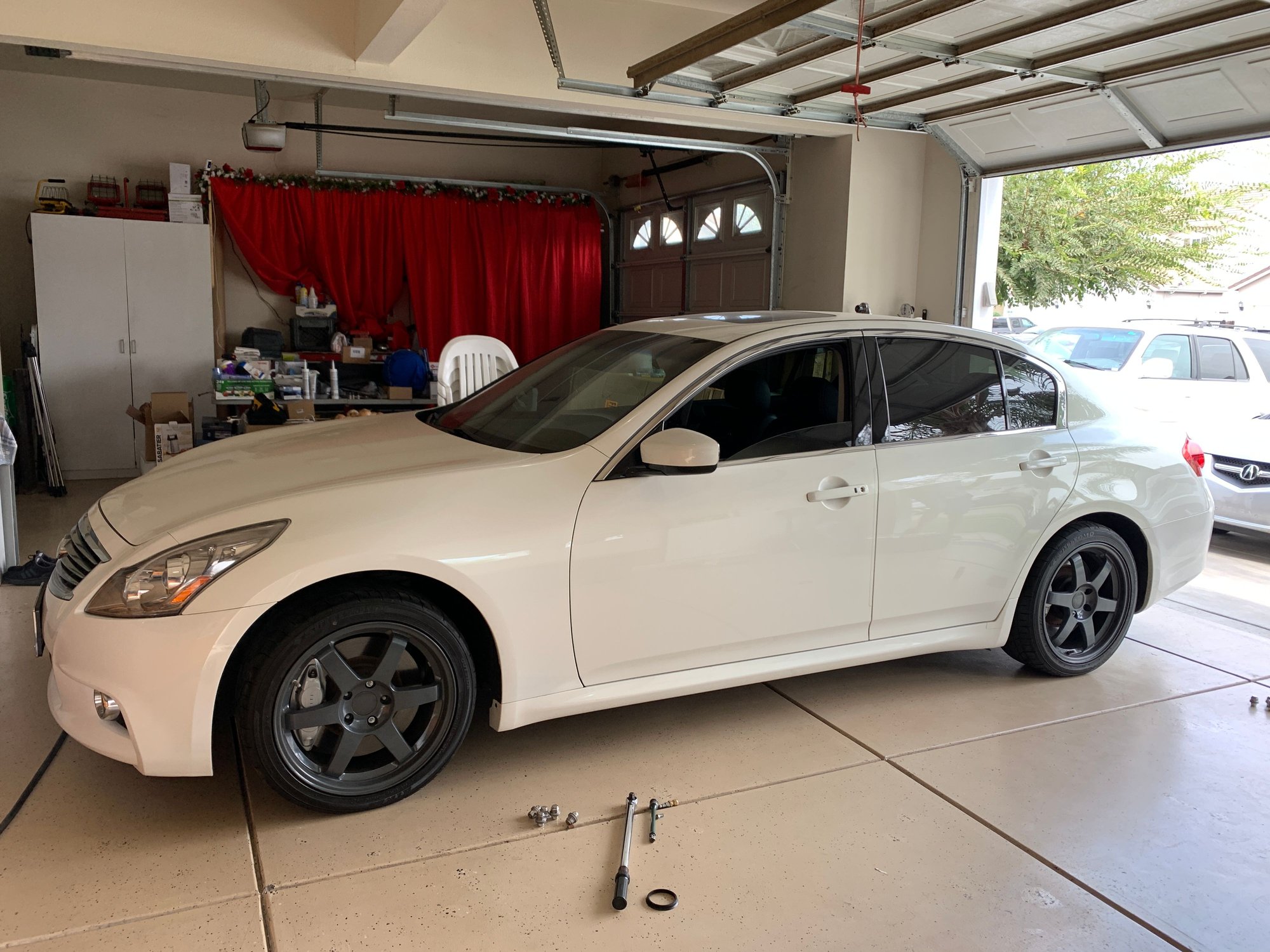

New 1
Front

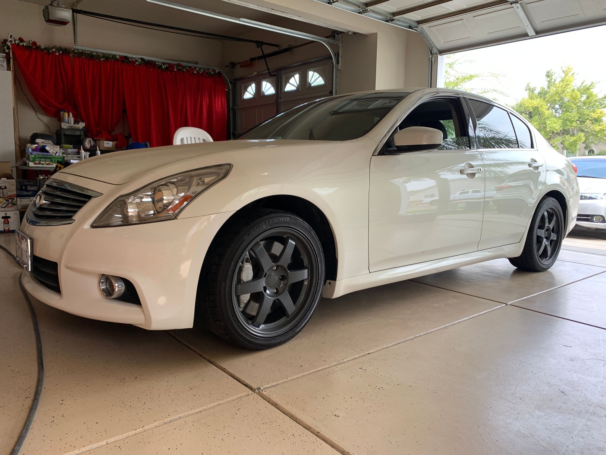

New 2
Front
Rear

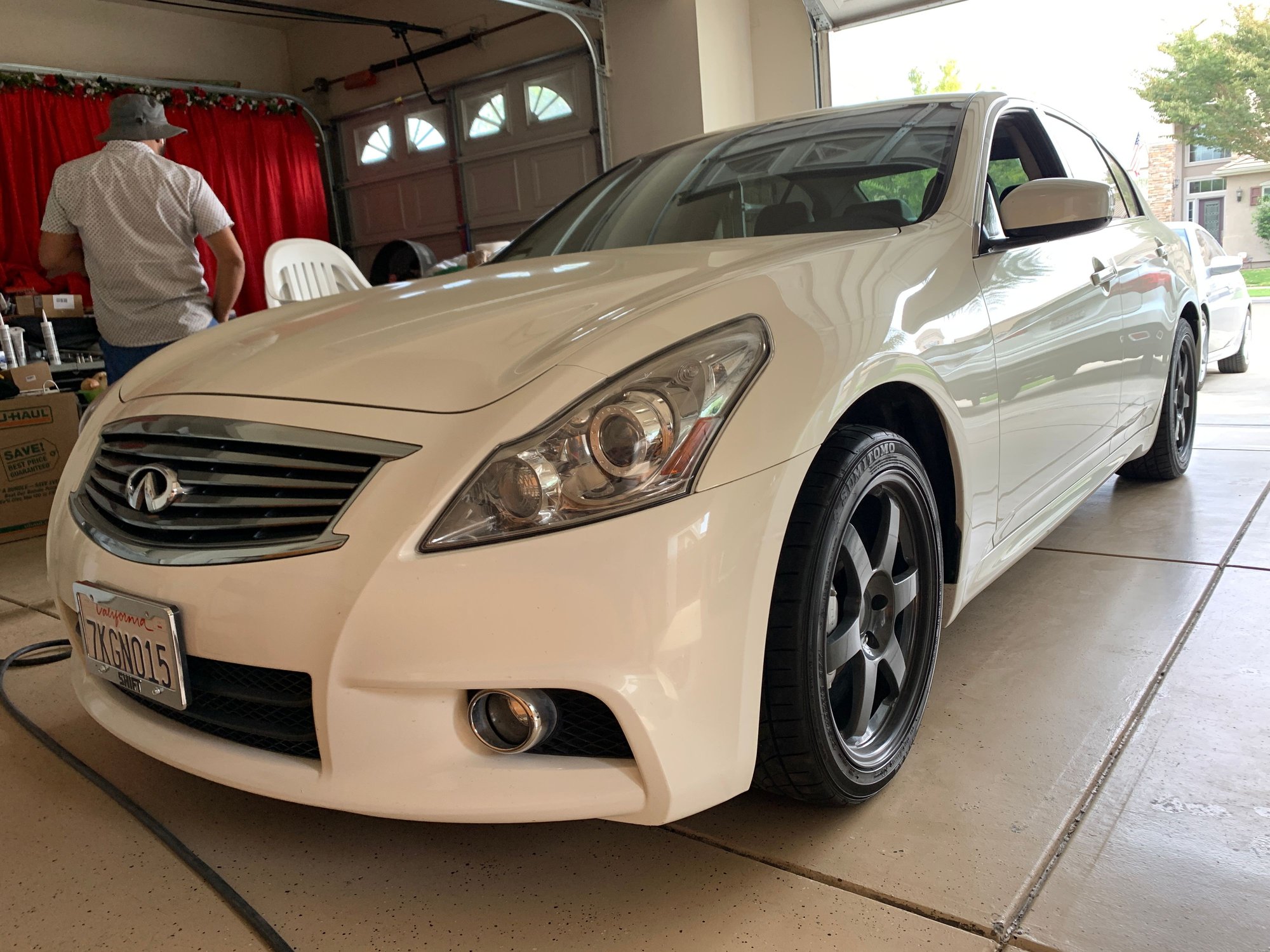

New 3
Front
Rear

Im not sure on the size, this was just a quick search to have a visual idea. I assume that all of the wheels posted are between 8-10 inches which the variation can backfire with the pics.
Another important factor is that the sidewall height is subjective to manufacturers depending on tire wear. Some will be a bit higher than others.

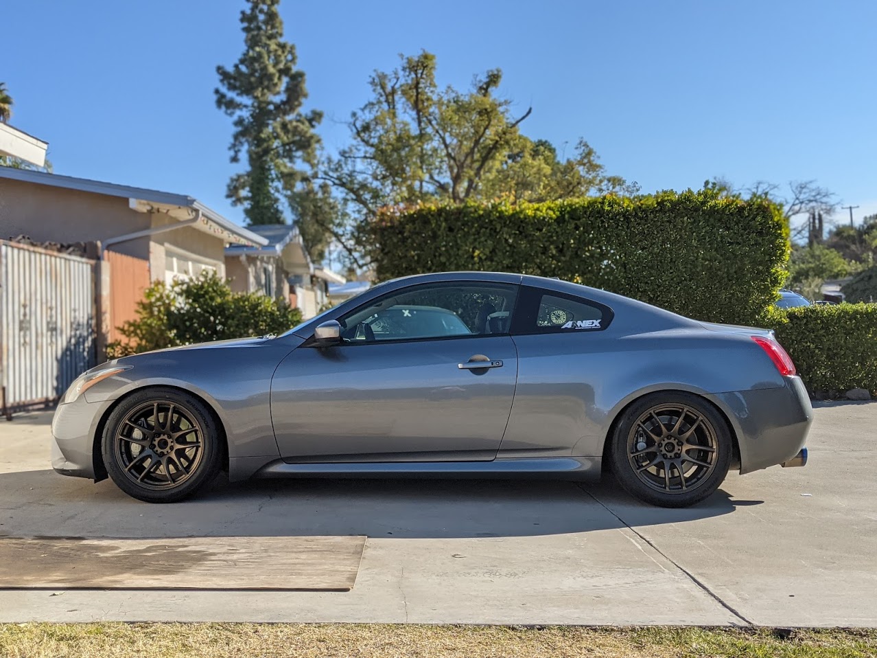

I could feel a difference going from a 26.3inch tall tire to a 26.7inch (stock). I've since gone back to 26.7inch tall, mostly to keep the OEM tire height and speedo reading. You can mitigate the sluggishness by finding a lighter wheel/tire combo. What's on the car currently?
This is an 18x9.5+30 with a 275/40R18 all around. 18 inch tires tend to be less expensive (and have better options) than 19s, although the selection problems are becoming less as cars move towards larger wheels.

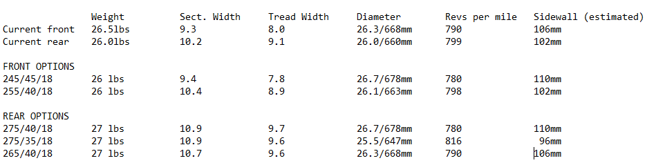

I got some specs on the actual tires that I'm using instead of using a tire size calculator, and then I compared it to the specs of the tires I'll be purchasing next time (Michelin Pilot Sport A/S 4) so I can get more accurate measurements
Here's what it looks like:
Soooo judging from these specific tires, I really don't want to use the 275/35 in the rear because it's way too small, like one of you mentioned earlier!
That leaves me with upsizing to the 275/40 option or going with the 265/40 which is in the middle. I am really liking the 265/40 option and it's not really much thinner in tread width than the 275/40!
As for the fronts, I'm actually leaning toward the 255/40. I know it's not as big of a stagger as stock specs, BUT will that matter very much? I don't understand the dynamics behind a staggered setup very much and how it relates to handling etc. Looking at the section and tread width, it's definitely smaller than the 265/40 though, so it's still staggered a bit.
The 245/45 option for the front is a bit smaller in section and tread width, with a larger diameter. How would this impact my ride quality, handling, and steering feel compared to the 255/40 up front?
Once again, I appreciate all of the feedback! I love brainstorming about these things.
