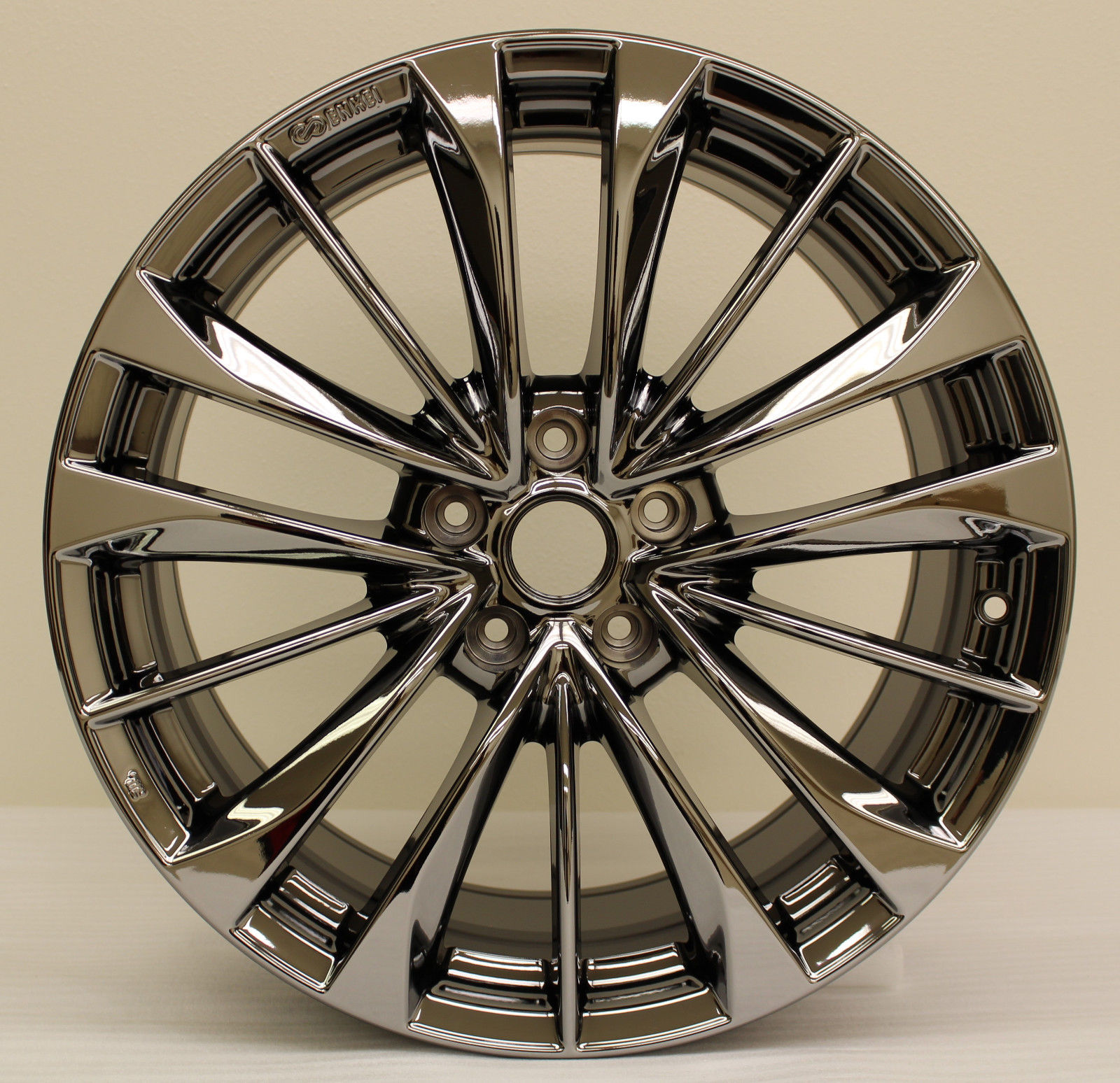

have 2012 base x coupe. I trusted ebay site and bought 4 19X9" enkei
D0300-1NL9K
problem is now that I have them I see they are for rear only and rear wheel drive model. I'm not sure if they will work on fronts or rear at this point? Do I get spacers? 10-20MM? I see the scary stories. what should I do?

Won't be a problem at all, the offset should be a +30 which will make the setup fit closer to the fender, but other than that you're good to go! Run 245/40/19 tires all around, should be very happy w/ the fit.

Thanks that is great news! I was going to go 245 40 19 with general altimax rt43. I was also considering 255. So glad I don’t have to return them or get spacers/adapters.

Think a 255/40/19 will be a nice overall fit if they have the tires in that size, nothing wrong w/ the 245/40s though.
