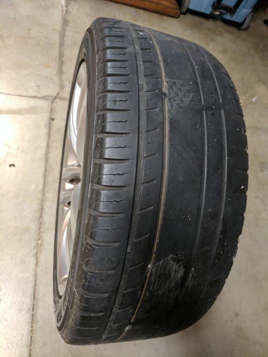

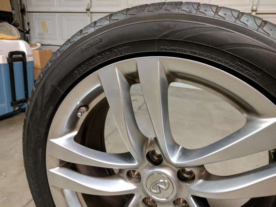

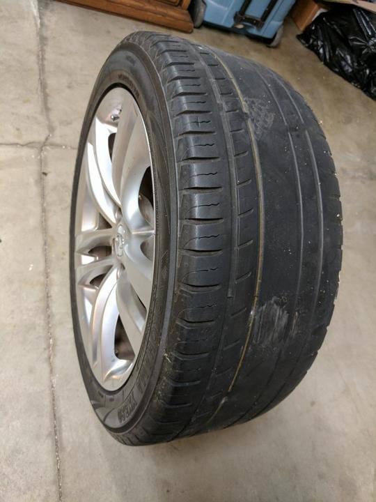

This is a 245/45R18 Yokohama YK580 on the stock non-sport G37 coupe wheels, which would be 18x8 +43. Keep in mind, your mileage might vary depending on the tire you choose - some run wider than others.

^^^Camber much???
Old Jul 15, 2017 | 02:05 PM
bPChaos's Avatar
bPChaos
Posts: 363
Likes: 66
From: Los Angeles, CA
Funnily enough - absolutely stock, including within spec camber. I think this one may have come off the rear, but I can't remember. They've been sitting in my garage for a very long time now.

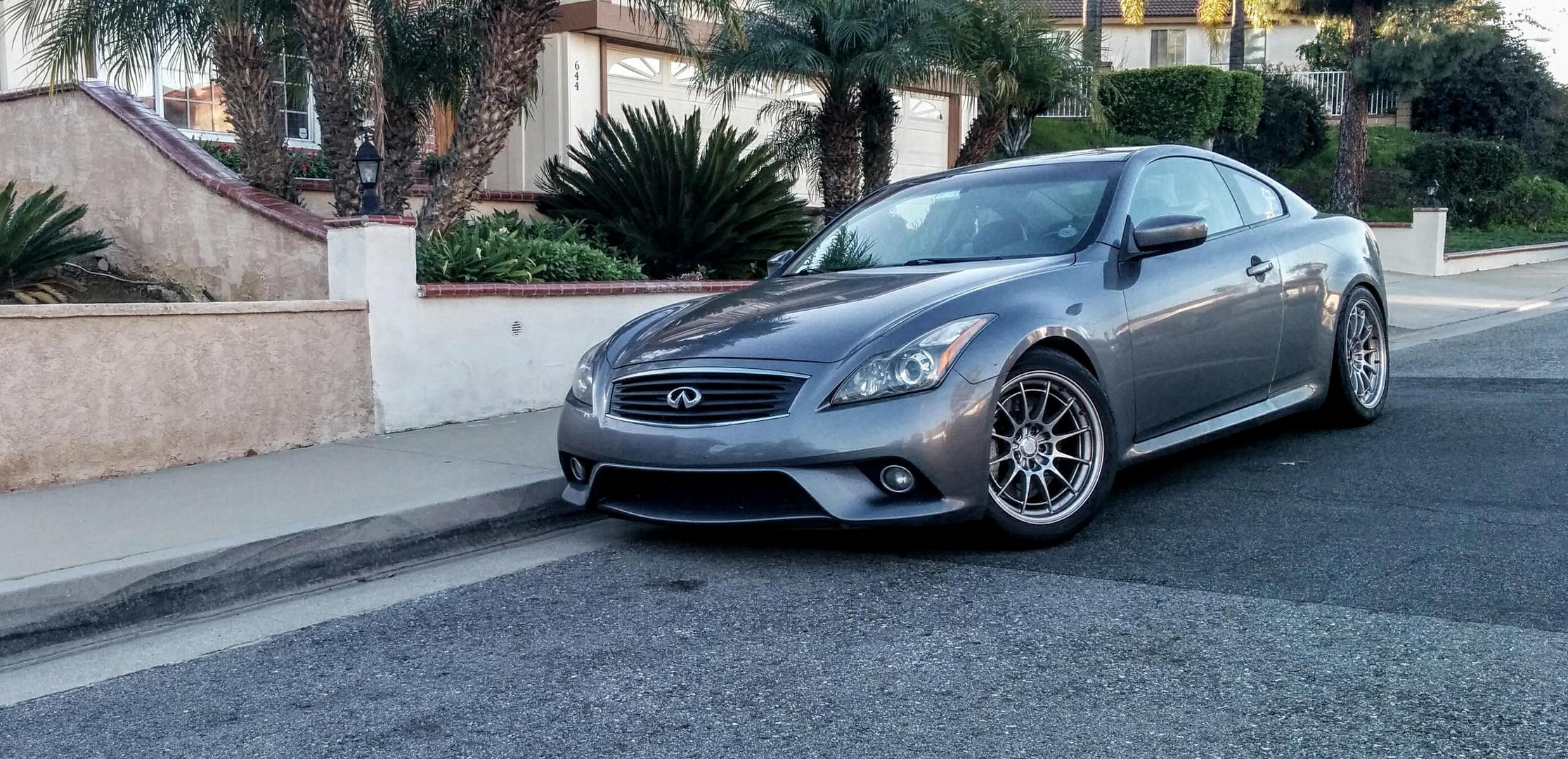

As an aside, the NT-03+Ms look good.
Old Jul 15, 2017 | 07:00 PM
Likes: 4,951
Agree, like those new Enkeis on there^^^^
