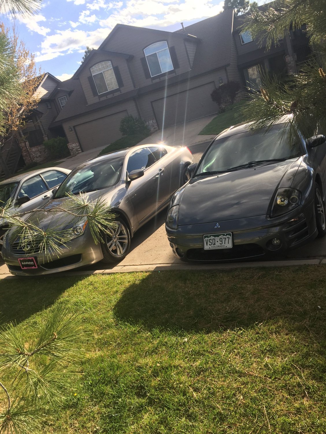

Hello,
Still somewhat new here. Just got my 09 G Coupe in May. Already looking into starting my build process, first thing I am looking at right now is wheels or even possibly wheels and tires if needed. The wheels im looking at are the Varrstoen ES2 ES6 OR ES9's. I want to know what you guys first of all think would look best. Secondly I am new to wheel fitment and such I need to know what size you think I should get 18' 19' or 20' and what tires I would need to fit with those. I would like to go 18' because the stock tires are for 18s and it would save me a bit of money out the gate but I also am not sure if 18 is big enough for me. Let me know what you think. Also if you have 18s, 19s or 20s post em here and tell me which size you got.
Heres a link to the ES2s im really digging in matte black - ES2 ? Varrstoen Performance Wheels
