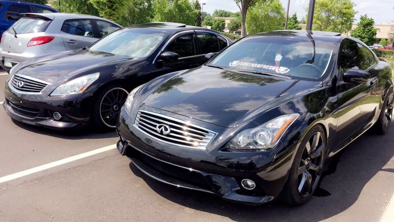

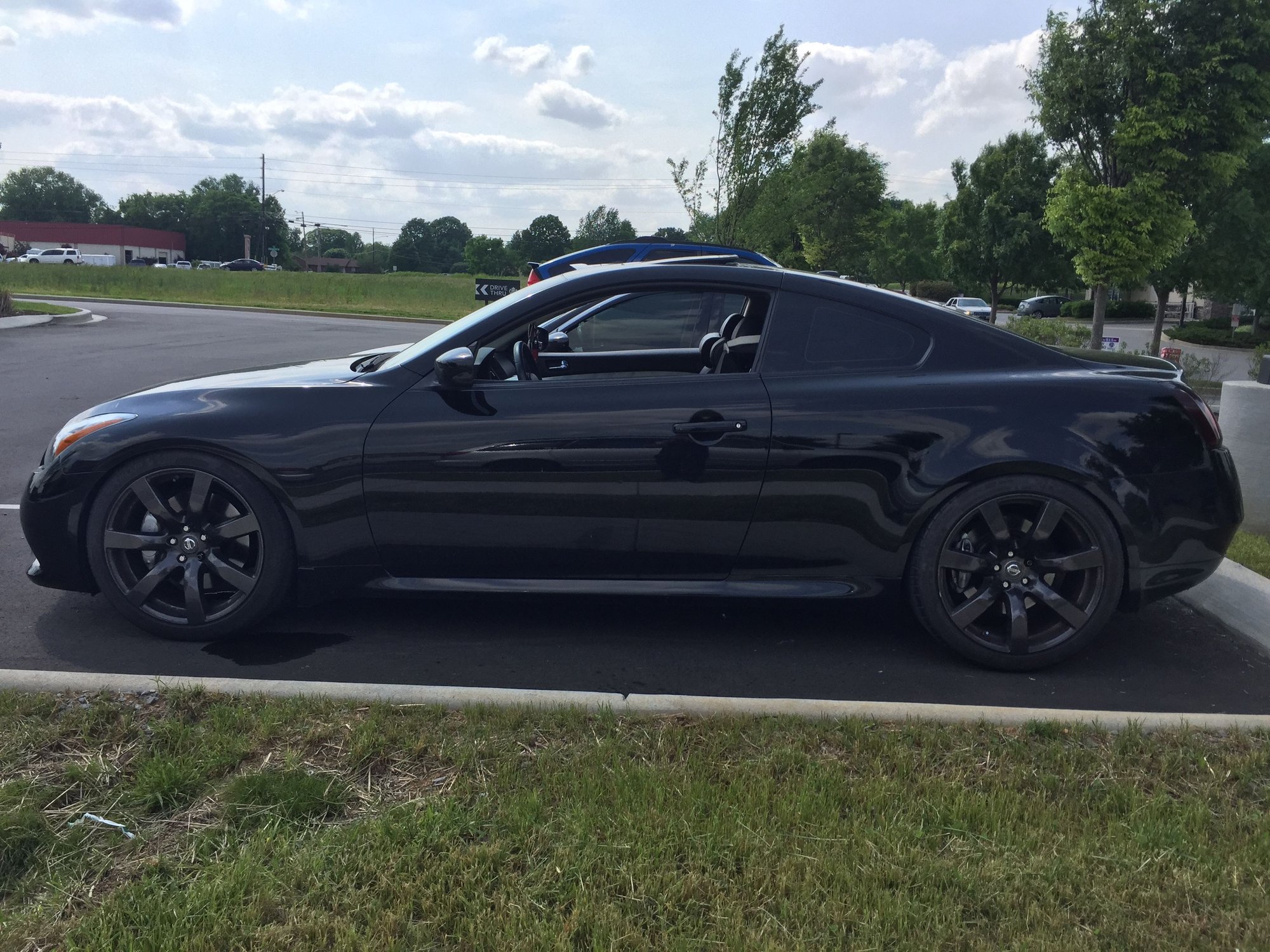

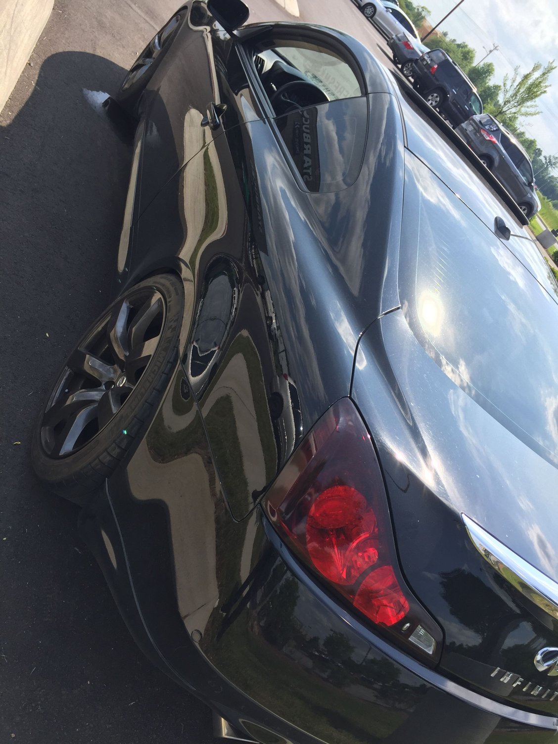

So I hammered the bumper bracket in the rear up some more to stop some of the scraping. The front clears where it was rubbing against the knuckle. I got to align the rear today at school, and got the left side to -2.9 and right side -2.0 camber (I know it isn't even but it's as far as it let me go on stock bolts). Didn't have time to do the front so maybe Friday I'll throw on the front camber kit. Here's some pics of how she looks as of now 🙂
