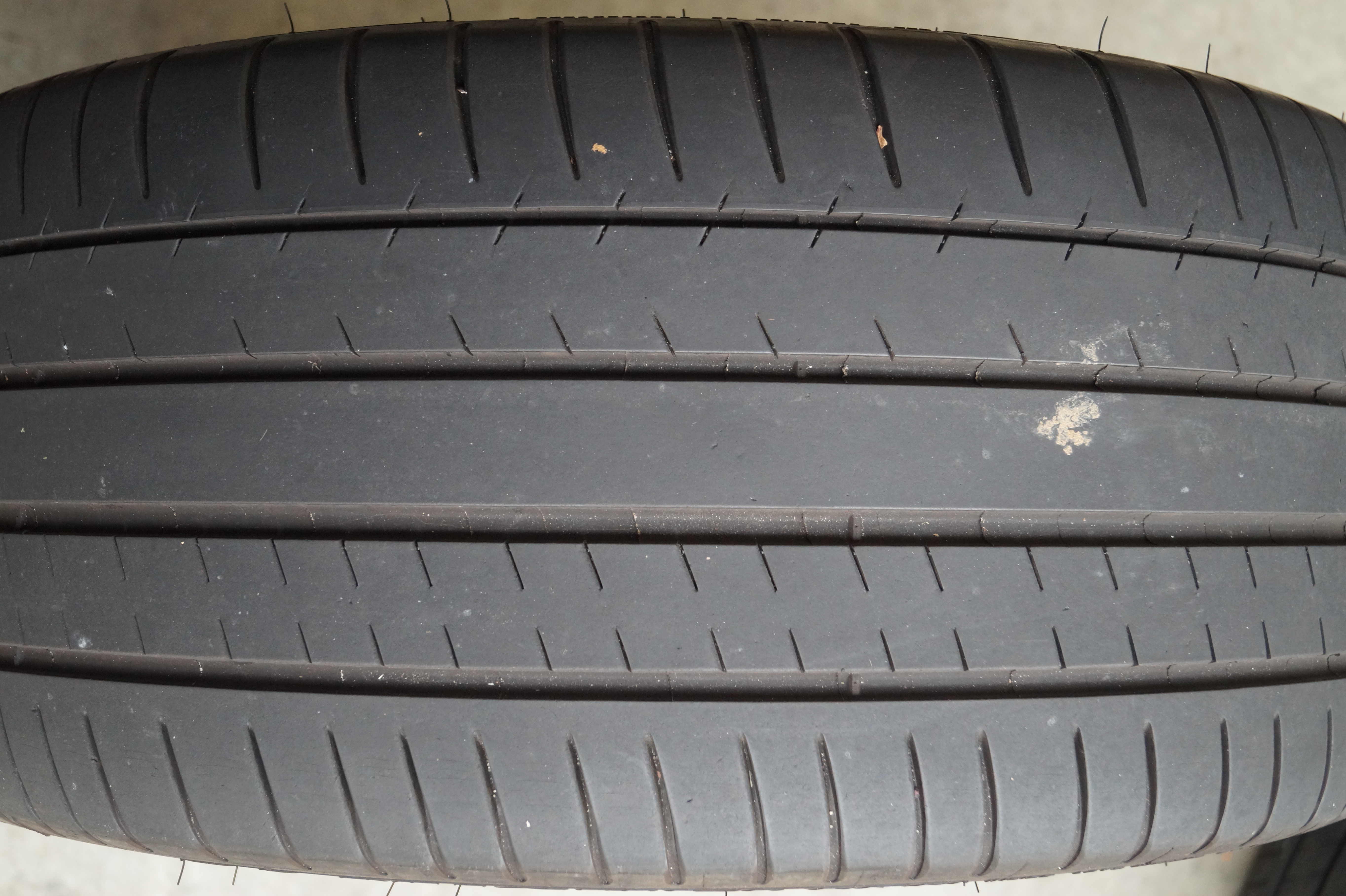

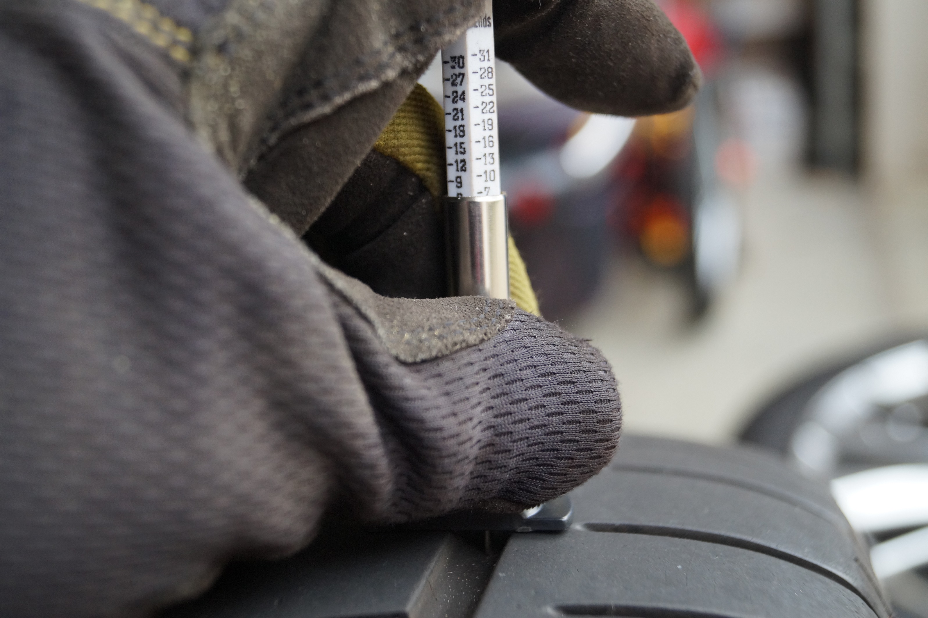

These pictures were with about 12,000 miles. I'm holding out for the new PS4, unless I can get a nice discount on PSS.
If it's any consolation, I generally have to replace my tires once a year since I don't have the benefit of running snow tires half the year.
Posts: 19,859
Likes: 5,149
Well damn, those pics look like new to me. That you only experienced 3mm of loss in 12k miles is heck of a thing for a tire like this.
