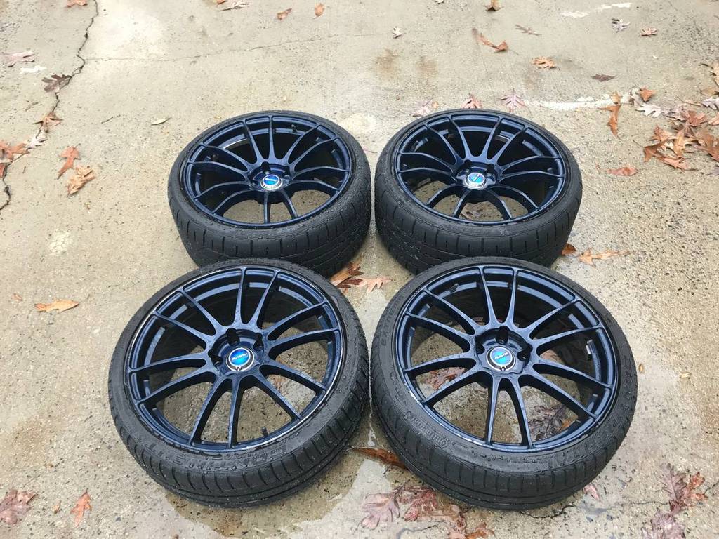

Rays Gram Light 57 Extreme 5x114.3 19 inch
Hello! I have a set of four Rays Gram Light 57 Extreme in winning blue color. These wheels are staggered, 19x9.5 +35 rear and 19x8.5 +33 front. PVD is 5x114.3. Fits Nissan/Lexus/Toyota
Wheels were used for less than a year, have NO bends, and are in excellent shape other than some curb rash on the front wheels. The front tires are shot and the rears are pretty much brand new.
VERY lightweight wheels made in Japan. Quality stuff, wheels alone cost over $2,200 new.
Includes blue Rays center caps that were an additional $100.
Grabbed the pic and description just in case... I've heard good things about these wheels. Is this worth driving 1 1/2 hrs to check out?
Also, would the 245/40 275/35 still be the best setup for these wheels?
