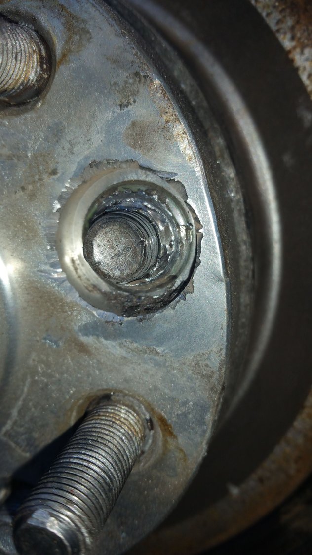

A while back I installed a set of 20mm spacers from b2autodesigns on my G37. The spacers are nice and very high quality in fact, but the same can't be said about the golden nuts that come with them.

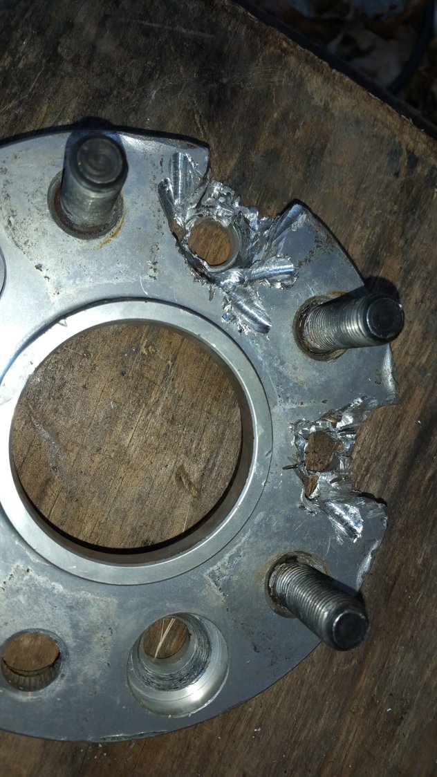

My front rotors needed to be replaced and it took forever because two (just two) out of 10 nuts did not want to come off. I did use the correct socket but because the nuts are really shallow and soft they rounded off anyway. I even tried special tools from Sears and this didn't really work either. Not sure if the nuts baked into the spacers or what the deal was but those two just didn't want to come off.
I had to use a dremel and plenty of cutting wheels to cut into the spacer to get it off. BTW, it was easier to cut into the wheels studs than the aluminum spacers.

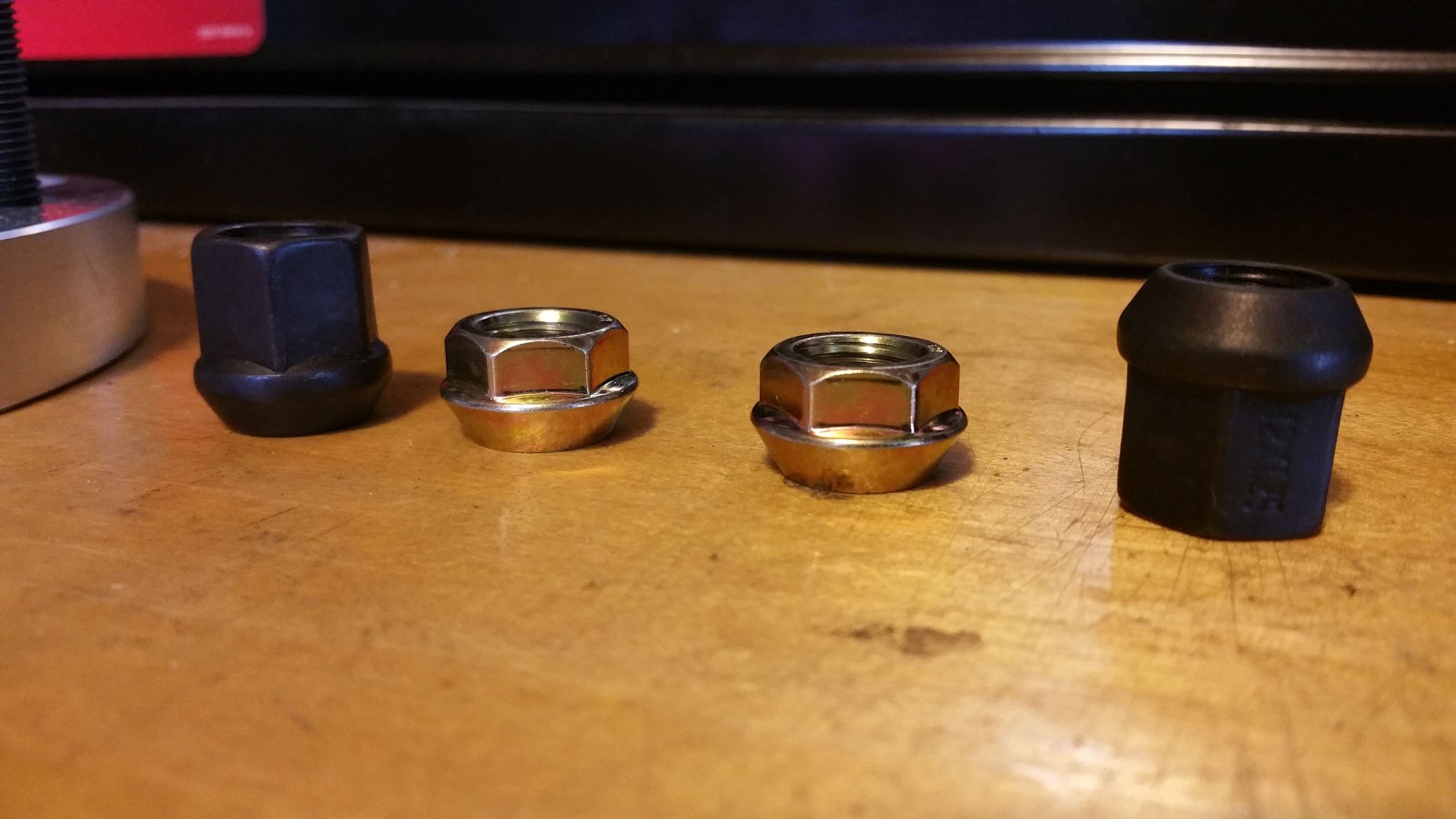

Anyway, just want to suggest that maybe you guys don't use the soft/short nuts that come with the b2autodesigns spacers. I was able to find some better ones on Ebay.. See pics attached:

What size are the golden ones

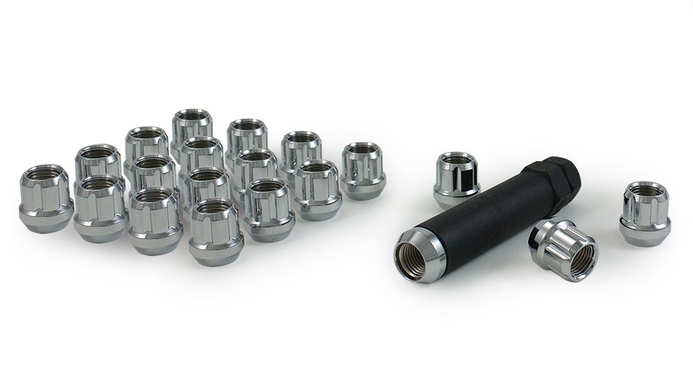

Coincidentally, I just received a set of 20 open-ended, spline drive lugnuts for this very use. That just happened today. Bought them through Amazon for $20.
https://www.amazon.com/gp/product/B0...?ie=UTF8&psc=1
This might be overkill, or complicated to explain to customers, but you might want to offer them an option like these nuts here, explaining that they will only work if the wheel used has proper clearance between the OEM lug holes. If I had known about this up front, I would have bought them with the spacer adapters, instead of having to figure it out after the fact. As in... this past Spring I had to bring the car to a shop to get two of those crappy lug nuts off. Fortunately for me, I didn't have to suffer the destruction the OP did.
Anyway, these are my new spacer adapter lug nuts. Cute little things, LOL.

I was going to buy the same nuts/lugs as you, but didn't want or trust the tool itself.
It's an industry standard, 6-slot spline drive. You can pick up a replacement key at any auto-parts store. I actually have two.
Unlike the McGard spline-drive, which is a proprietary 8-slot design
