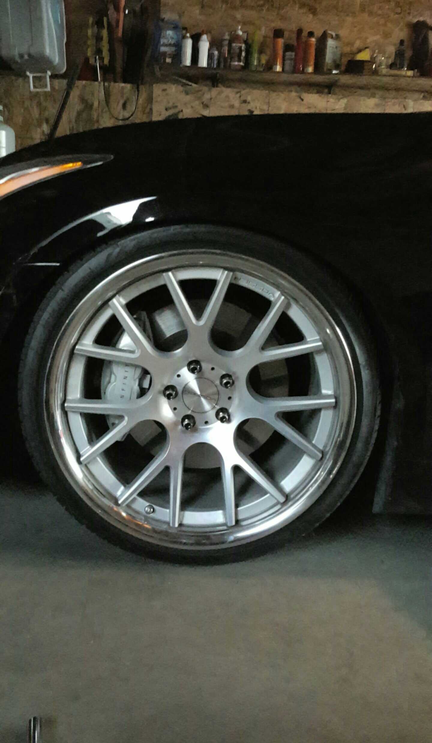

ur wheel looks bent

I have the same issue with my front tires as well except I am running a 275/35/20 size. I am on coils and my toe was in spec and I don't have a camber kit. I haven't had the time to see what can be causing this. For now I am not driving it. I am curious to see what caused this serious tread wear.

I forgot what my camber specs were but I know I am few degrees off in the fronts. The tires I have on are also very wide. My buddy sold them to me and he had them on his g35 sedan.

wheel looks bent
toe is way off
