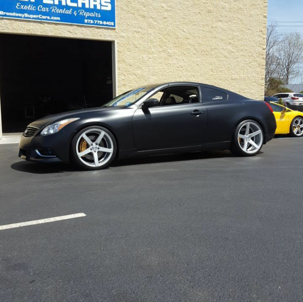

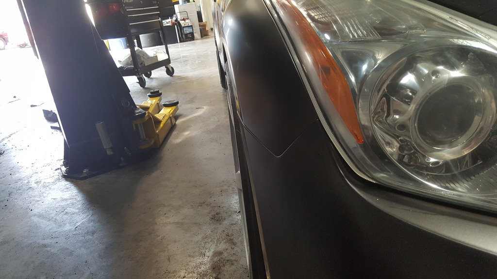

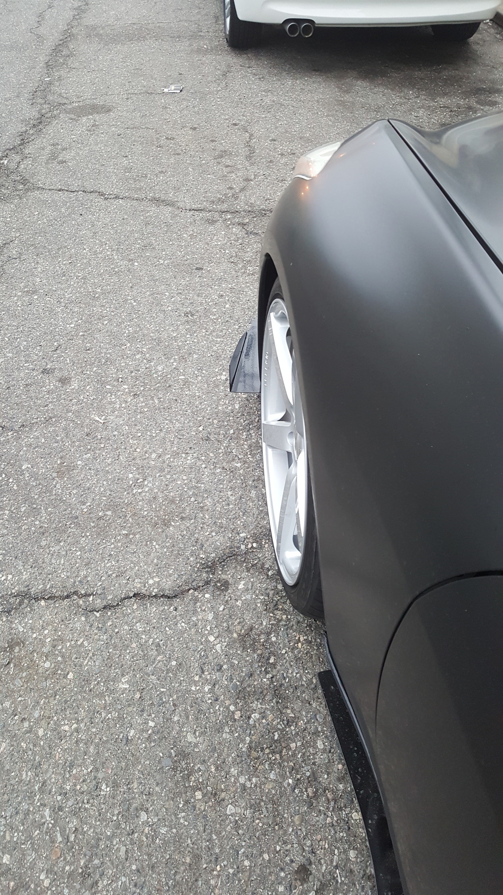

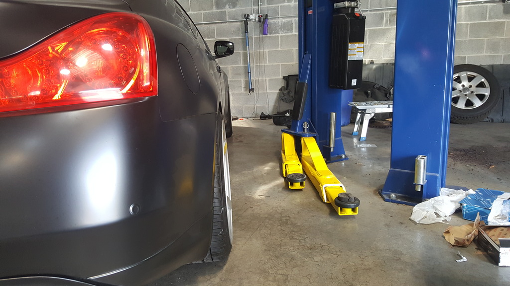

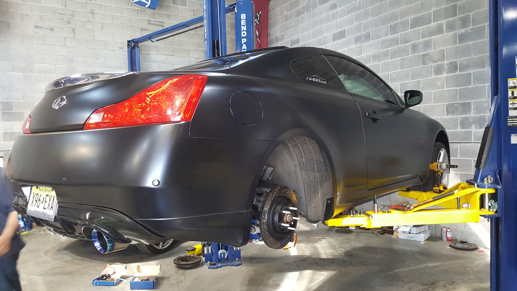

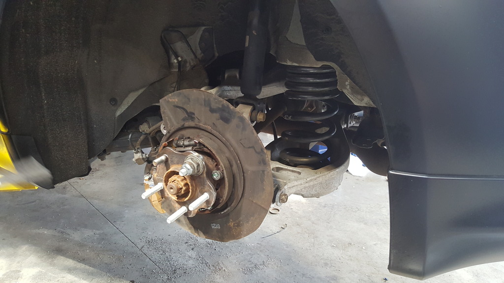

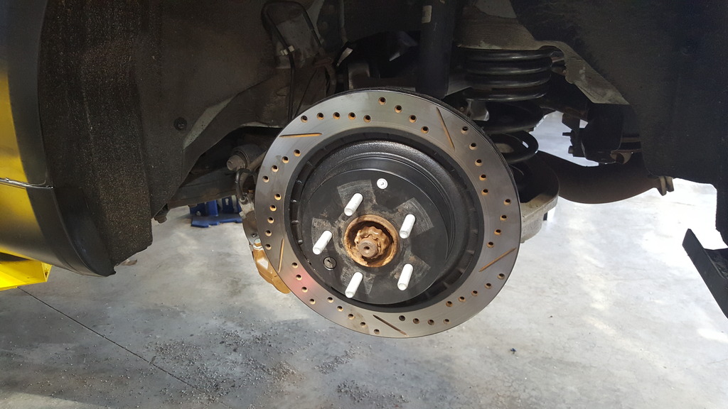

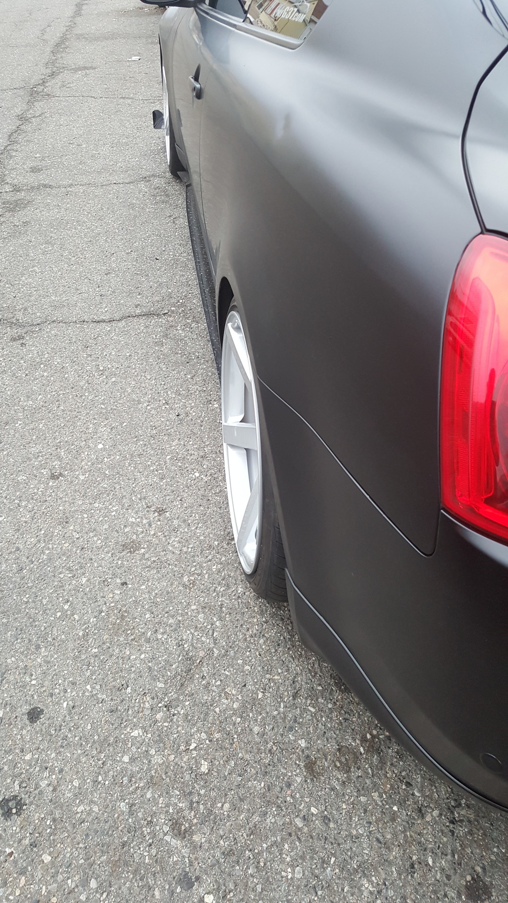

So after a long long journey of trying the simple task of adding wheel spacers to my wheels the journey has finally been completed! Small rundown of my problems is that i first ordered two sets of H&R DRM 15mm spacers but then realized my rear wheels didn't have divets in them for these kinds of spacers and were a flat surface so i had to reorder H&R DRS spacers with the extended studs.
I also realized my rubbing issue was horrible so had to trim my rear brackets to the absolute lowest possible amount where it wasn't necessary to remove completely and also cut about an inch off my fender lining and bolted that to the top of the fender wall. All in all it took me about a month of waiting and working till it finally got finished

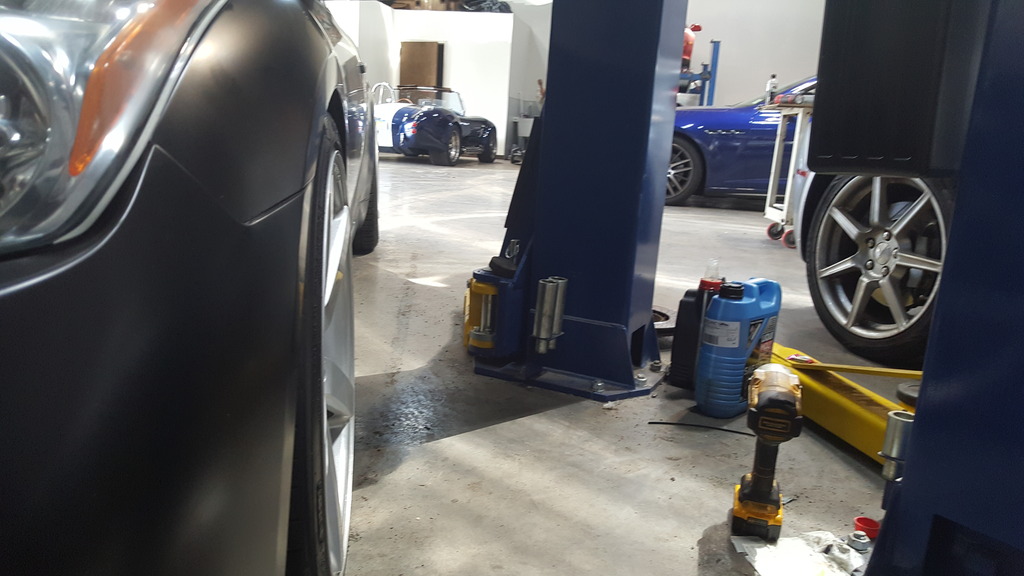

To install the studs i went to my good friends brothers shop called Broadway Performance, located in Clifton NJ, and also runs an exoctic car rental agnecy outside of his shop so i had an awesome 2 hours just hanging around there and learning by helping with the new studs installation. He was also kind enough to take me for a drive in one of the lambos theres and i must say CHECKED OFF THE BUCKET LIST! Top 10 experiences of my life! IT WAS AMAZING!
Now my baby is sitting hella flush! I hope you guys like the pictures of my car as well as some other goodies I took while being there.
Wheels:
20 Vossen CV3-R
Front- 20x9 32 offset currently 17 after 15mm spacers
Rear- 20x10.5 45 offset currently 30 after 15mm spacers

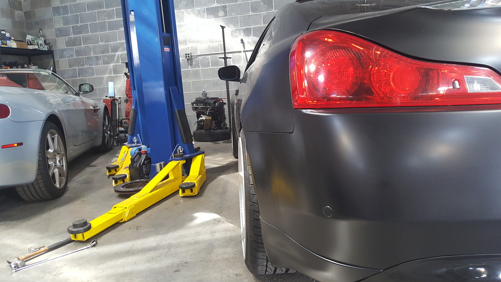

AFTER

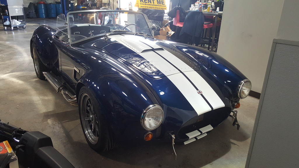

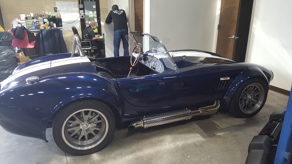

Backdraft Racing Shelby Cobra

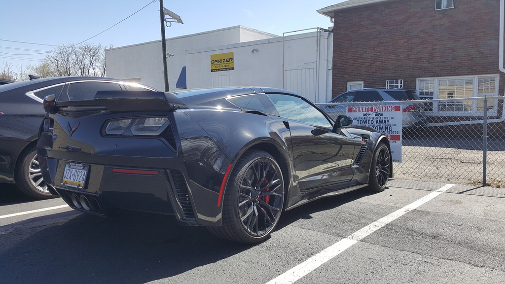

Brand spanking new Corvette Z06
