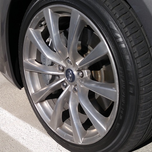

Its very, very punishing. Which is why I have delayed finishing them. However, right after sandblasting metal, the rims are a very rough and matte surface. Sanding with a 120, 320, 400, 600, 1000, then dry sanding with 2000 for polishing, and topping it off with a rubbing compound is the way to go. But again, it really sucks. With that, I'm going to buy the dremel sanding/polishing kit this weekend and finish them off. I'm leaving work soon, so Ill post pics of the current condition.

Heres my sandblasted rims. Note; theyre not yet completed, in which Im going to sand and polish them a bit more this weekend. You can see the blemishes and imperfections which are the result of not sanding deep enough/not using a lower grit. But with time, patience, and destroyed hands, they will be an almost chrome finish once complete.
Wow that looks like no fun. At least you have the more simple spoke wheels. The ones I have would be an even bigger nightmare.
