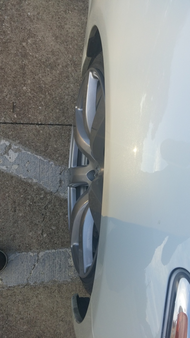

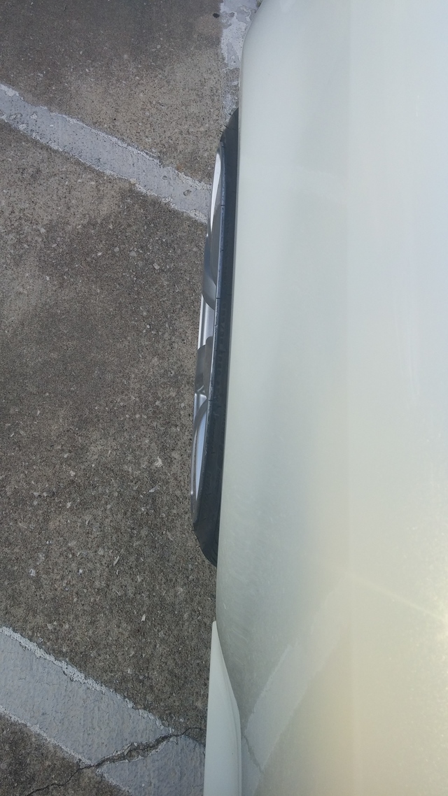

Ran them for a few months. I was running 255/35 in the rear and 225/35 up front. I would definitely suggest a little more meat for the tires. Careful with the rear though because they poke a bit, so as mentioned, a little camber is needed to clear the arches. The front wheels will probably need a 10mm spacer to look good. They were too sunken in for my tastes.
REAR PROFIILE:
FRONT PROFILE (without spacer):

Thanks guys... I am presently running 255 on the rear and would like to go to at least 285, even 3015 of they will fit. The lower positive offset will bring the wheel out more increasing the chance of rubbing on the wheel wells, so you are right some additional negative camber may be required. I'm not crazy about doing this as I was wearing out the outer edge of the tire with lots left on the inside
Nice to see the pics... thanks! I think the meaner look of the GT-R wheels is perfect for the look I want.
