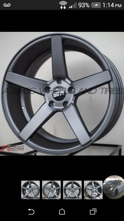

I got my 11 X-coupe back in August and just buying parts from now til springtime. I have Eibach Pro-Kit Springs and just ordered 19X8.5 +15 19X10 +20 STR 607 wheels. Does anybody have this set up out there? Any problems with the rear fender, need cambering, or tire stretching?

Nah I can return them or resell them if I don't like them. I want to see other people who have them mounted on. Ya know, see how theirs turned out.

You'll have to run stretched and since you're AWD you'll have to be very careful w/ tire sizing. A 225/45 255/40 combo will work well w/ your AWD and shout give you enough room at the fender, if not, a little extra negative camber should slip them in
