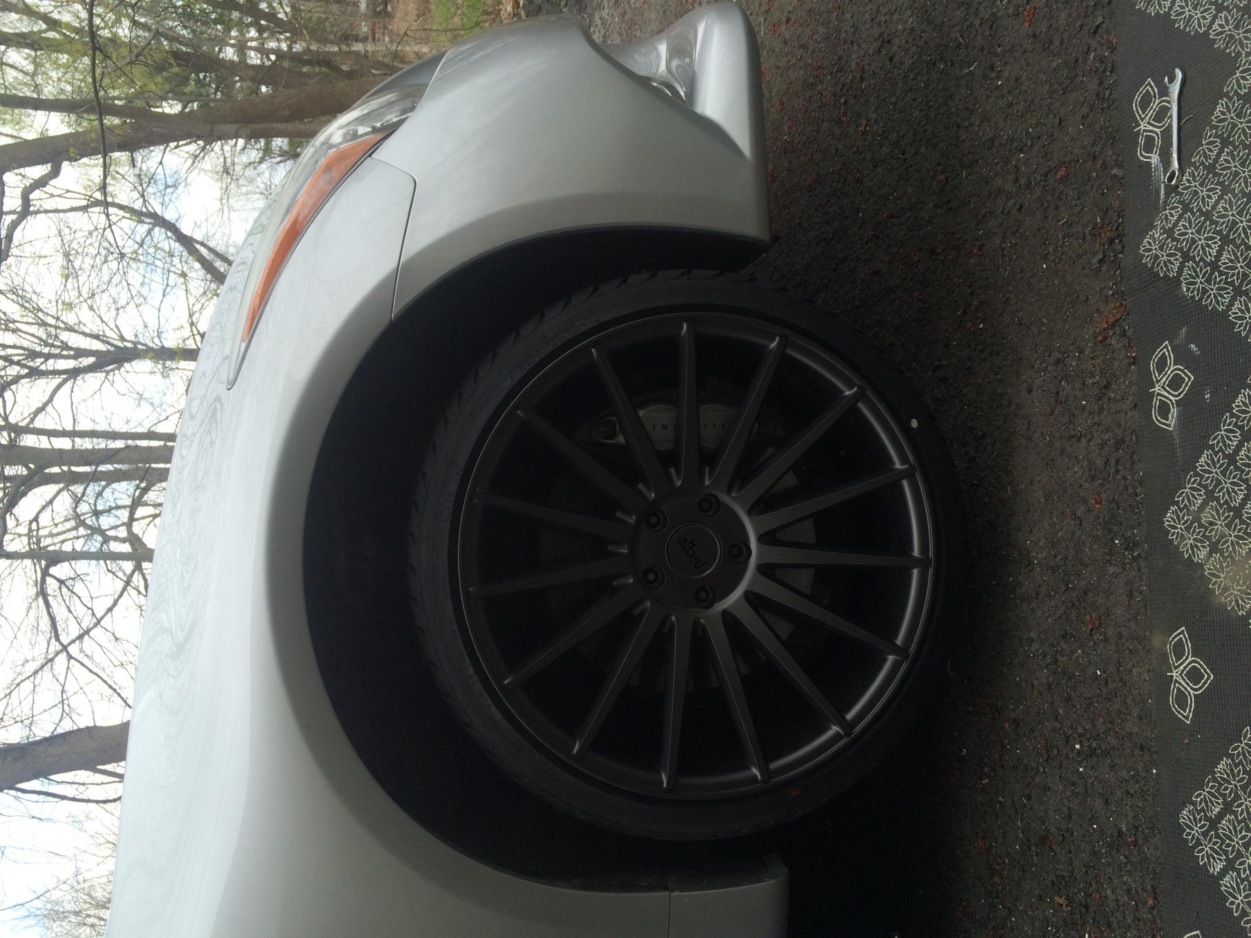

Wrong fitment
Well, i purchased a pair of niche m157 flow form wheels. They are 20x10 +40 all around. when i spoke to niche i kept telling them i had the sport brakes. they said that the 20x10 will fit. now that got them, the spokes kit my calipers on the front but fit in the rear. idk what to do now .. should i just buy spacers for the front, and also for the back to compensate for the front? if so what size spacers should i get??

Front spacers only, but you'll need to see how much clearence you need. We can't guess what you need...

My guess is 15mm spacers.

What you should do is one of three things~
1)Use this template on the backside of your wheel to determine how much spacer you'll need~
https://conceptzperformance.com/imag...nttemplate.pdf
2)Use a few stacked flat washers on three of your 5 wheel lugs and gently place wheel onto hub and verify brake clearance when wheel is snugged up. I'd start w/ about 1/2" worth of stacked flat washers and if that clears see how much room you have between spokes and caliper. If you can go less than 1/2" and still have at least 2mm clearance everywhere on the wheel then just measure how thick the stack is and get the approximate spacer to match that stack. I would put a couple strips of painters tape over your caliper to keep it from getting nicked up when test fitting. If you need more than a 1/2" then you might want to consider option 3 since your front wheel probably will now be too far out for your liking (maybe)
3)Contact Niche and see if they will agree to accept a full return on the wheels since this was based on information they gave you.
G/L and keep us posted, those are some nice looking wheels, hope you can get them fitted up OK.
And I'd not worry about any rear spacers right now, but eventually if you end up needing to space your fronts then more than likely you'll want spacers out back. A setup with rear wheels tucked more than fronts won't look right.

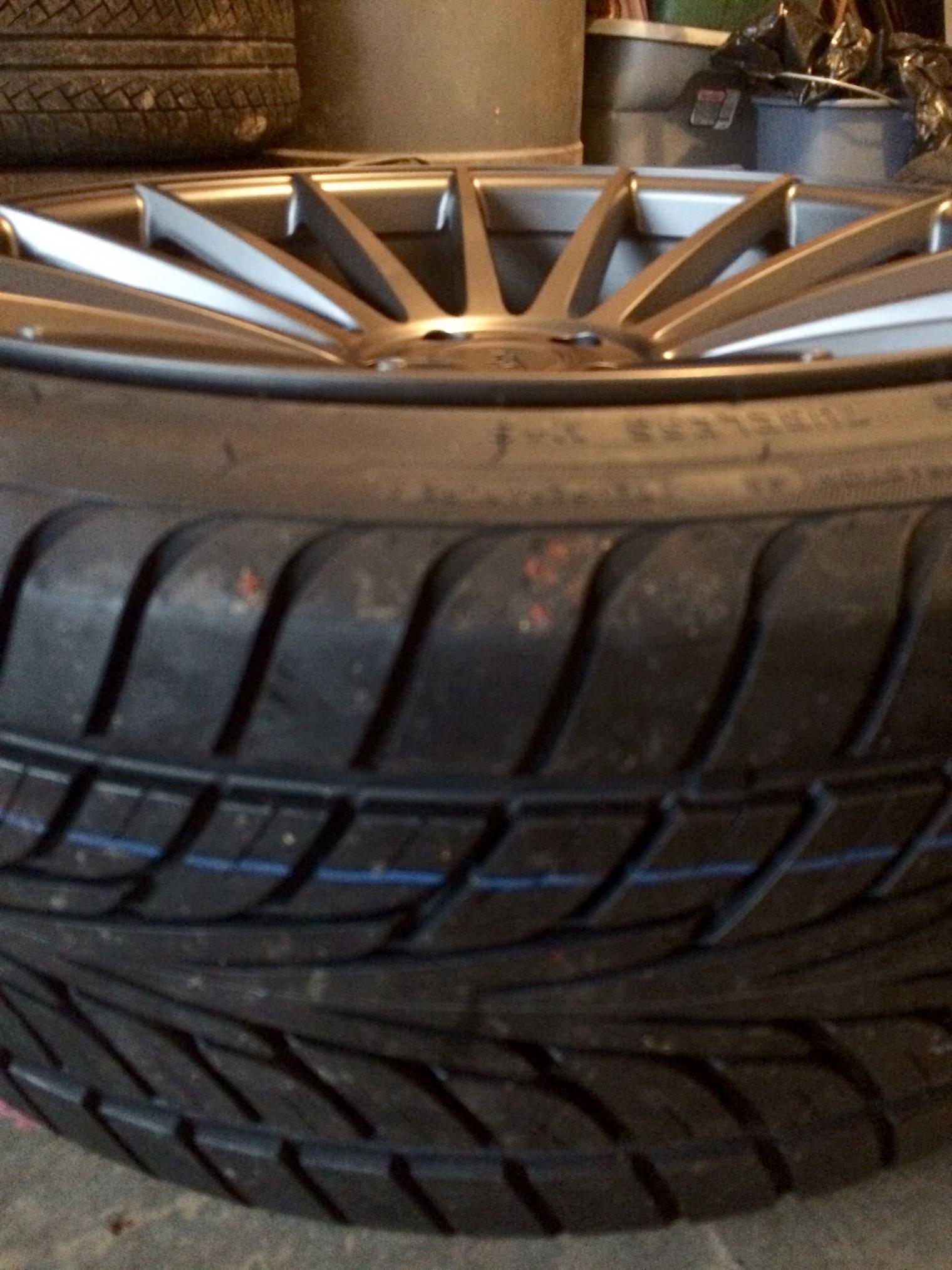

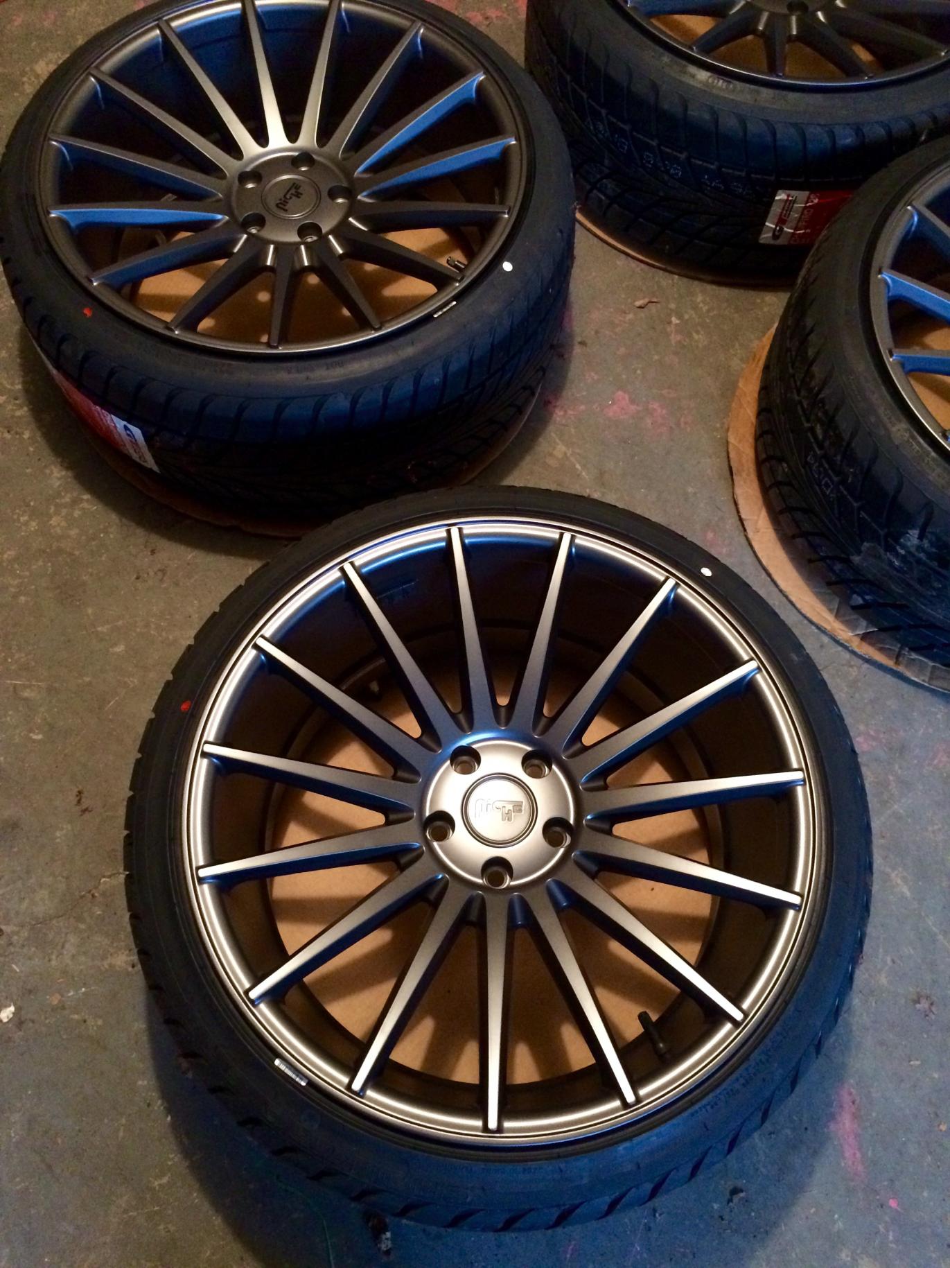

heres a picture from when i first got them

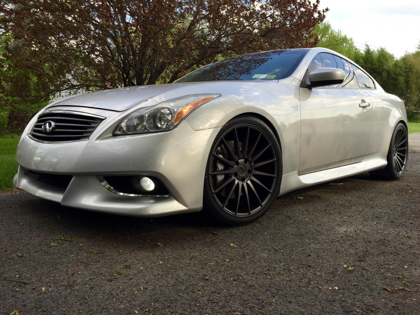

hey guys i got everything all mounted up and heres the result
