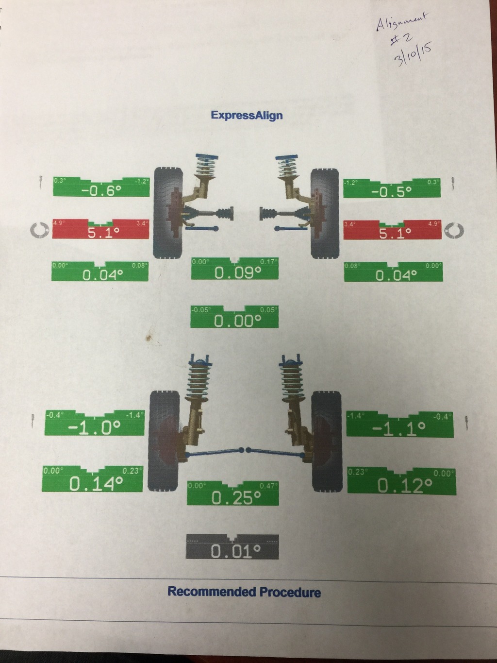

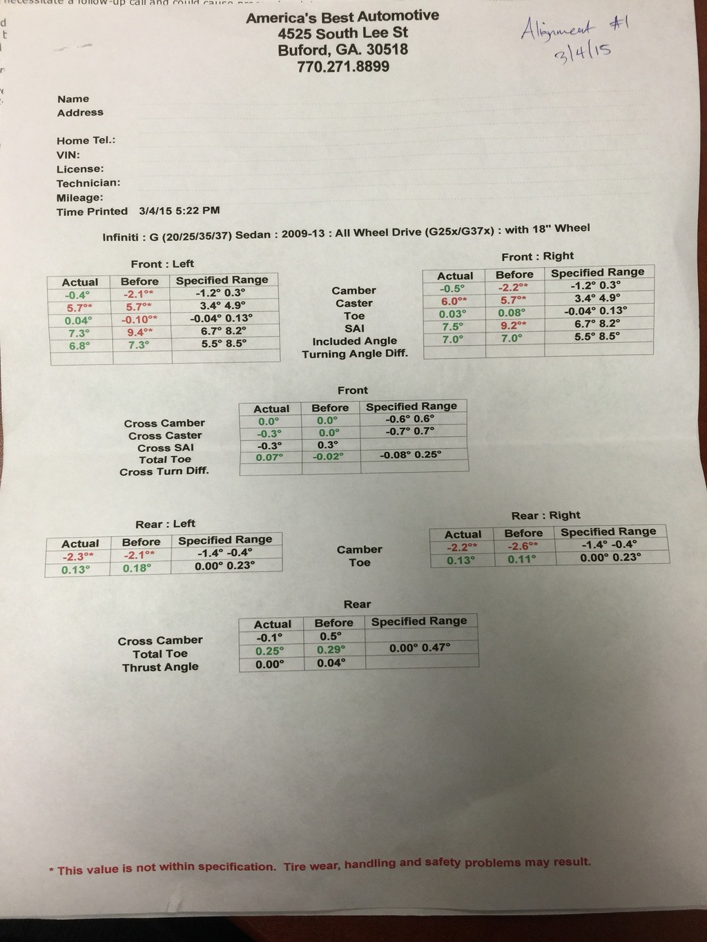

Furlow, you're right, I didn't mention what I was lowered on. I meant to do that but missed it. I have Fortune Auto 500 coilovers. 10k/8k front/rear. Comfort valving. Dampening settings are 7 clicks from softest setting on the front and 5 clicks from softest setting on the back.
First alignment was last Thursday. The before numbers on this one were from after putting the new coilovers on.
Second alignment was from yesterday after the rear camber kit was installed.

Alignment specs look good. I'm scratching my had at your rear camber (before) because your car just doesn't look that low. I guess coilovers will do that though. Anyway, good to see you are back in line.
