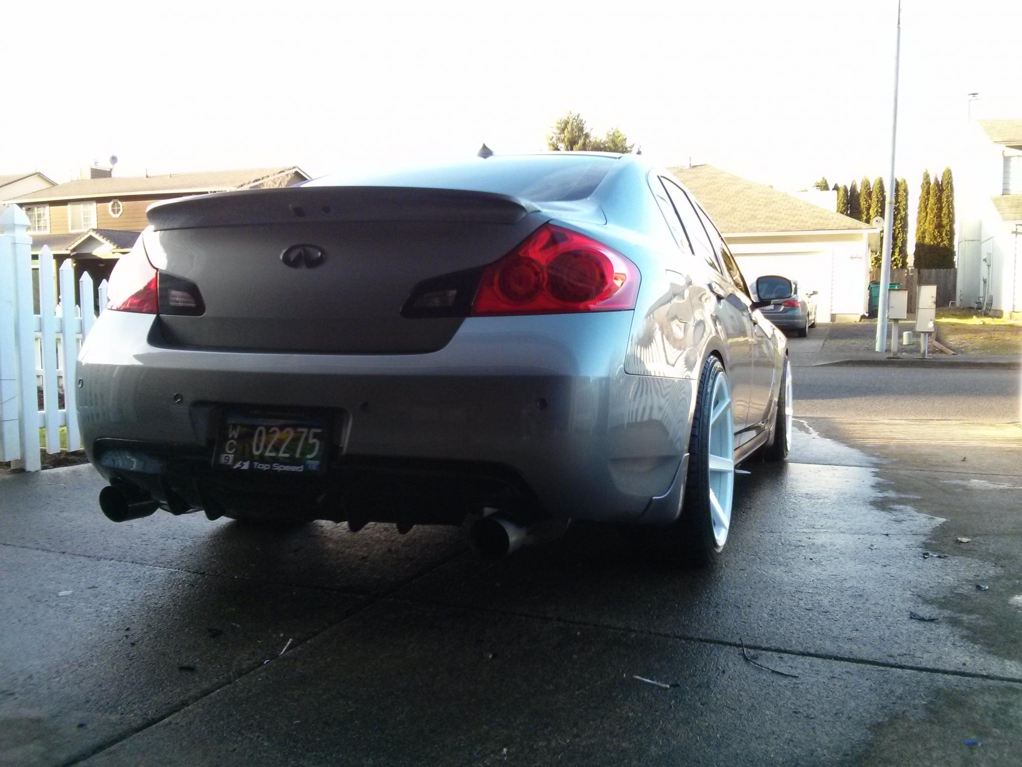

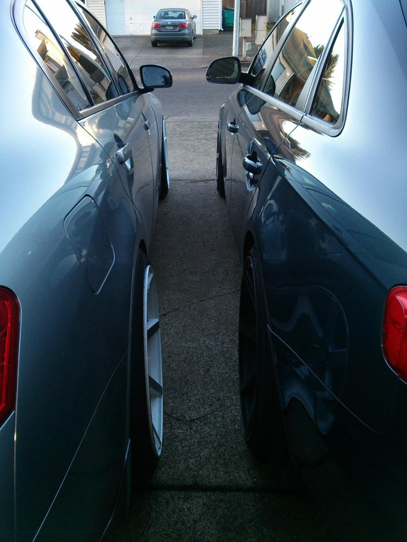

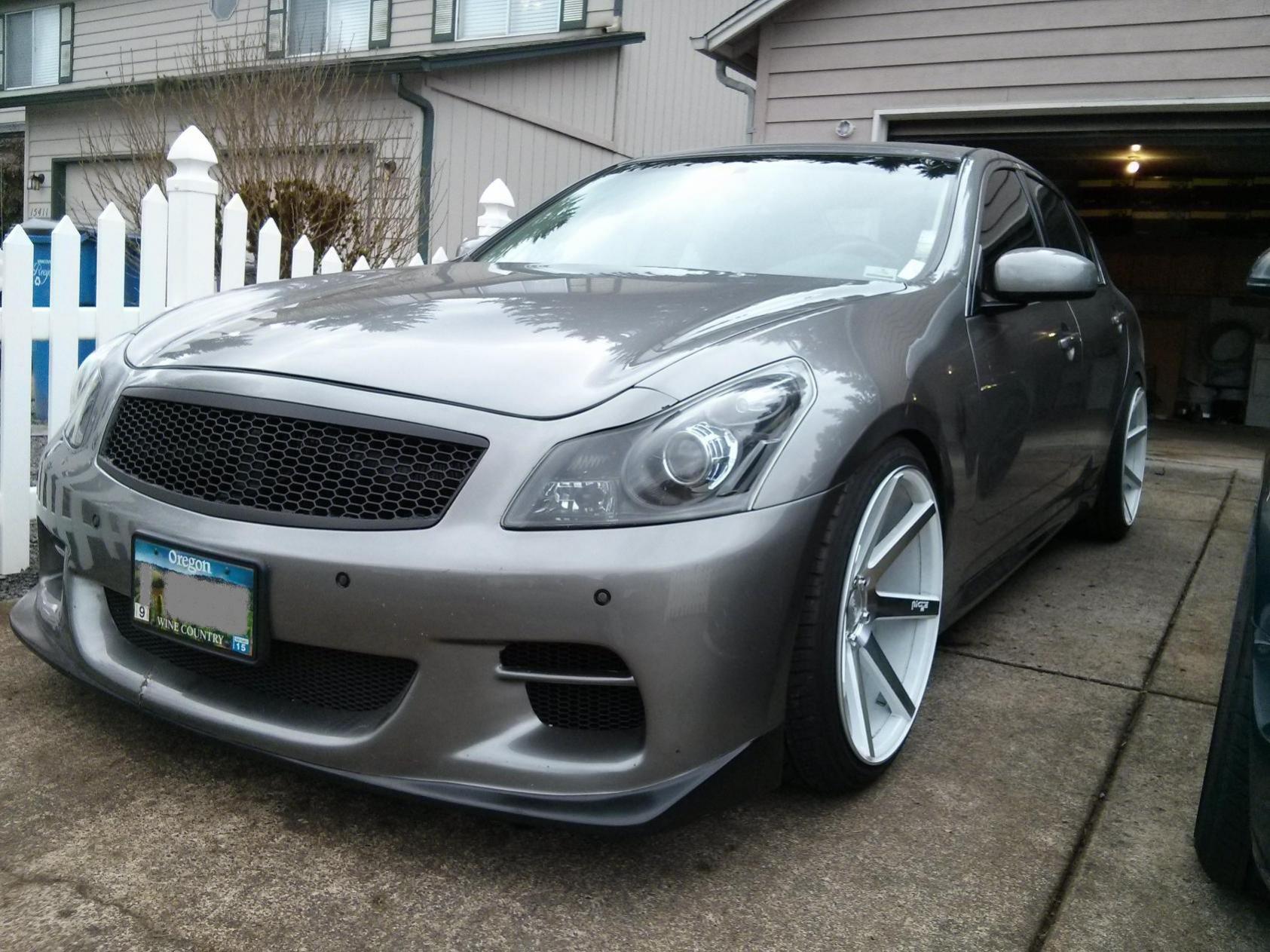

Hey guys,
Sorry to bother you, but I was just wondering if anyone knows the owner of this G35 Sedan ?
I would like to know his wheel setup, what is he lowered on, how much negative camber is he running, etc. I'm thinking of going with his setup. I know he's running 20x10.5 +30mm offset all around. I messaged the guy but seems like he's not active in this forum anymore. What kind of work do you think he did in order to install the wheels without having any rubbing issues and stuff ? I'm mostly by myself during the week, and I probably would never have more than 4 people in the car. I'm lowered on H&R springs, which I believe dropped the car around 1.3-1.5".
Thanks
Attached Thumbnails Aftermarket Wheels-img_20140311_183101.jpg   Aftermarket Wheels-img_20140312_180432.jpg   Aftermarket Wheels-img_20140316_153503.jpg

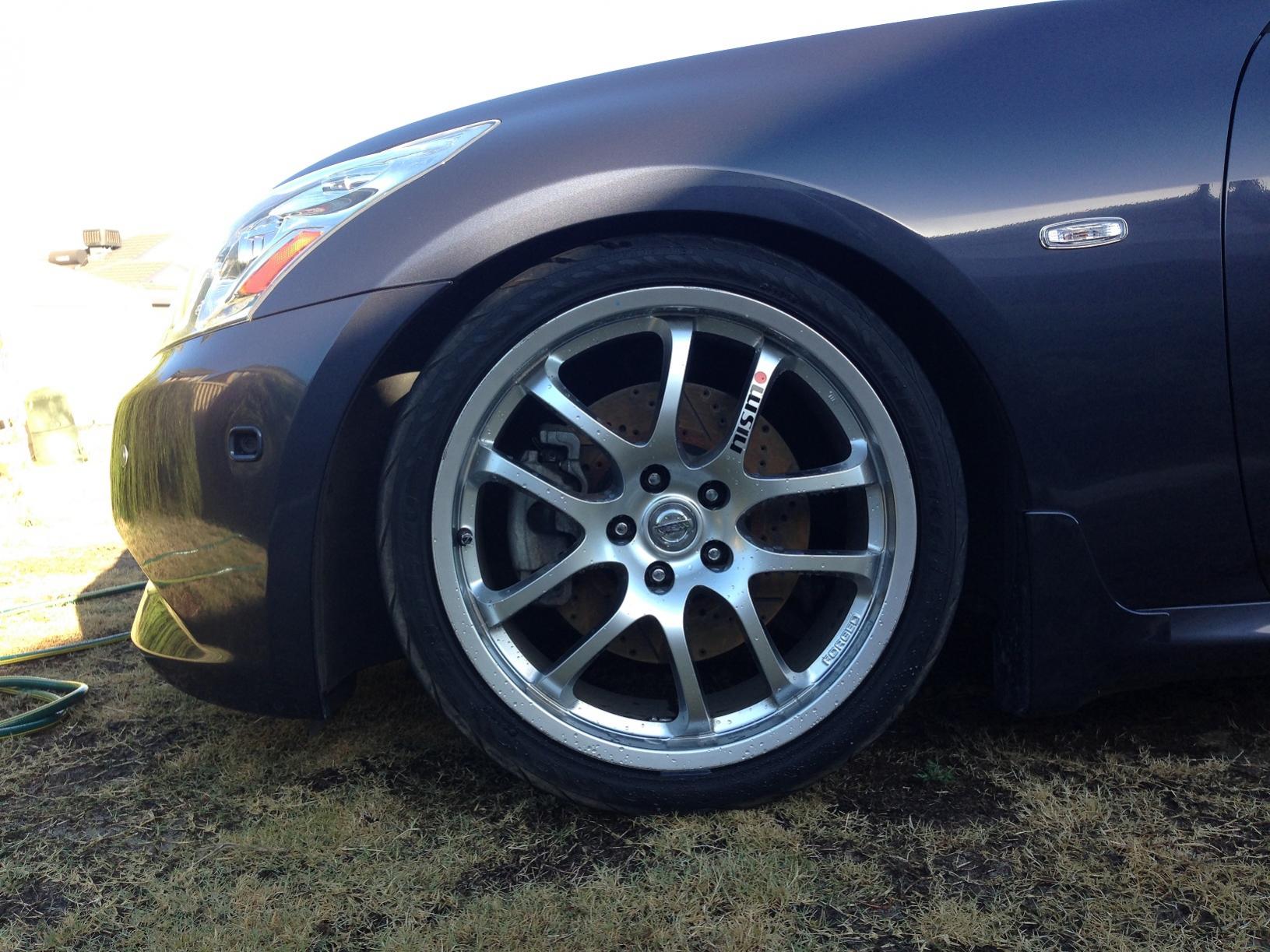

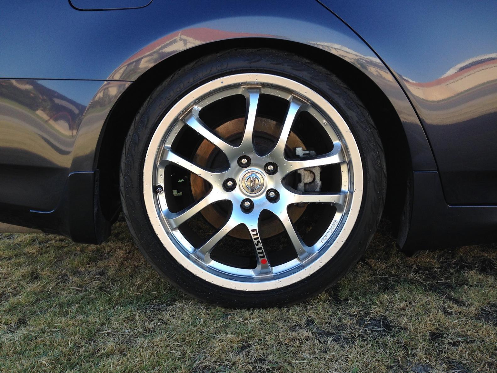

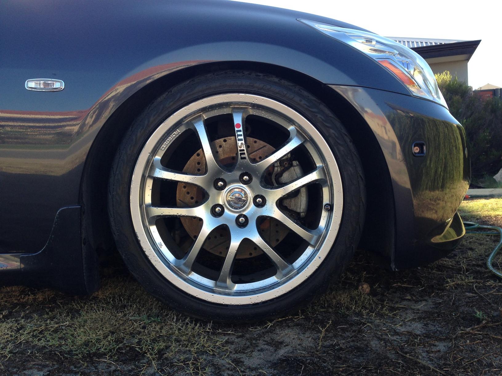

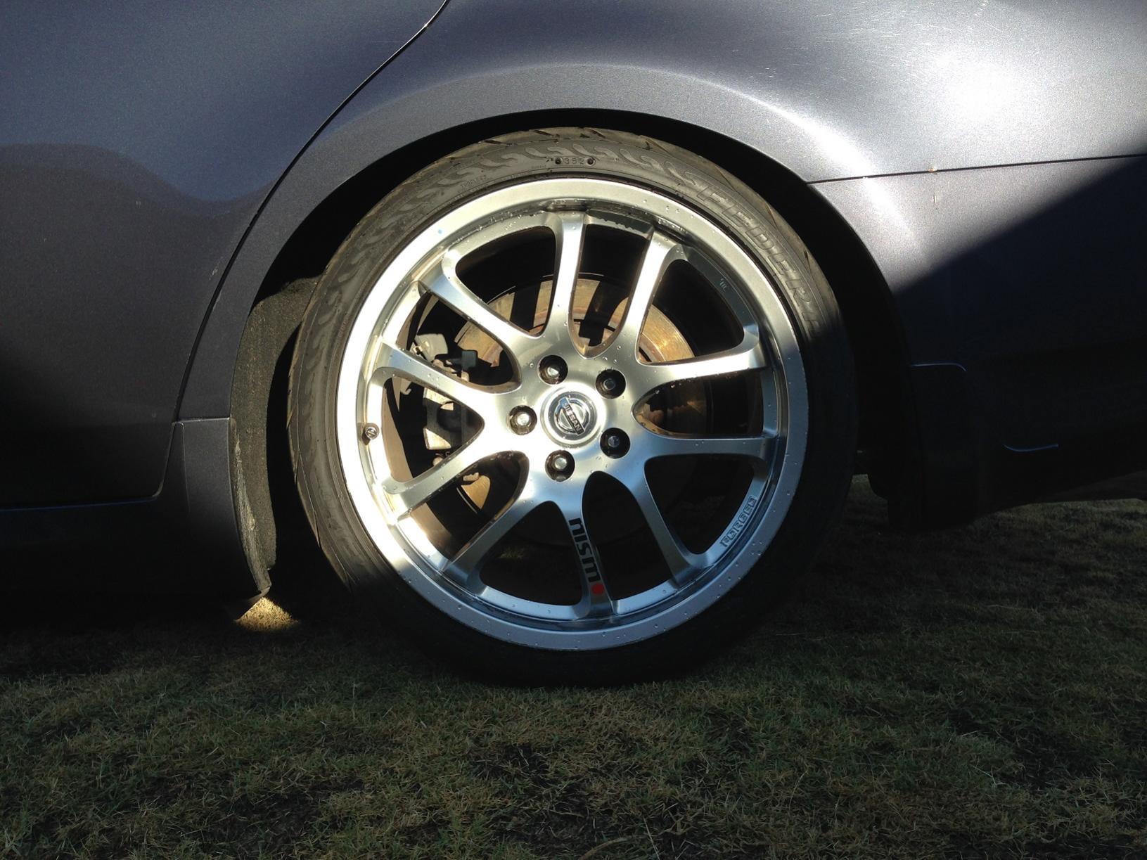

If it's any help, this is how my car currently sit and how much wheel gap I have.
Attached Thumbnails Aftermarket Wheels-img_2503.jpg   Aftermarket Wheels-img_2504.jpg   Aftermarket Wheels-img_2505.jpg   Aftermarket Wheels-img_2506.jpg

With that drop you can might be able to get away with 20x10 +40 depending on tire size. What Springs/coils is your car dropped on and camber figures all around.

Oh, sorry for posting on the wrong section. I'm lowered on H&R springs, about 1.3-1.5" drop. I'm not sure about that, I lost the paperwork from the last wheel alignment that I did .

Check this thread, there's a couple other sedans running similar 10.5 square sets

I have experience with H&R springs so I can help you. The drop is close to 1.8" front and 1.5" rear. You can run 20x10.5 +35 all around with 255/35/20 with minimal bracket trimming both front and back. Or you can do 20x10 +20 with the same tires sizes. Also if you want to go staggered then 20x9 +20 and 20x10.5 +30~35 depending on tire size.
