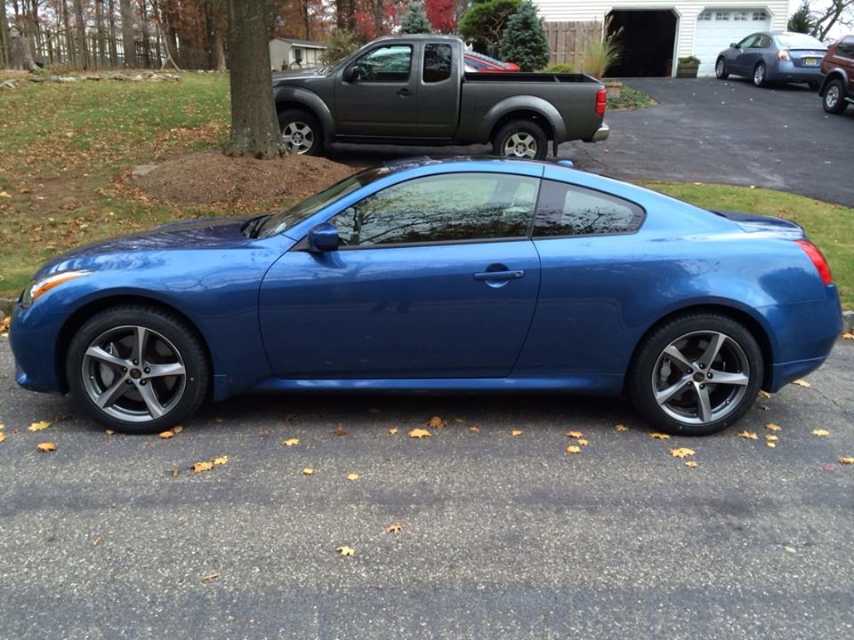

Don't bother getting the MB Twist wheels in 18" x 8" size from discount tire direct the fronts don't clear the stock Akibono brake calipers. I'm very angry because it's too late to return them so I'm forced buying wheel spacers now. I live chatted with someone on the site prior to purchasing them & he assured me there would be no problem with offset with the bigger brakes. The wheel will fit & turn but hits the caliper when bolted down glad I didn't drive without checking my calipers would've been a mess.
The backs fit fine it's just the fronts that are the issue. Anyone think 5mm wheel spacer kit will be enough? I currently have the spacers that came on my 08 sti when I bought it installed thank goodness they never sold but those are overkill the tires stick out of wheel well about a 1/2" & the inner hub ring don't fit so forced to run without it. They are the 20mm ones. I'm thinking if I can use the 5mm ones I would only need the fronts & the spacing won't look too bad.

Sorry to hear of your issue, what you can do is use this template (just stick it to some cardboard) and fit to the back of the wheel, this will show you how many mm you'll need to clear them. You can also stack a few washers on 3 of your lugs and gently fit the wheel on the hub to check for clearance. You want about 3mm of clearance just for piece of mind although since the caliper is fixed some have gotten by w/ just a credit card thickness
Here's that template, and hopefully just a 5mm spacing will get it to clear OK.
http://infinitig37.com/tech-images/akebonotemplate.pdf

Thanks for your reply. I had my brother in law just look at it he said the 5mm should be fine It was only 1-2mm off so the 5mm ones will give me 3-4mm play. Here is what they look like on the car if anyone is interested. The backs will fit fine but you will need 5mm spacer kit for the front if anyone is interested in getting these.
