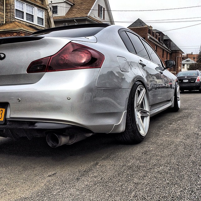

This is the G I bought wheels from

You bought these wheels from Peter in BK right? It didnt look too bad in pics on his G with a spring drop. If you weren't planning on a drop then its time to start shopping for new wheels.

Yep, that's a very aggressive setup, you can see the heavy camber and very tight fit, you can see the rims are already outside the fenders at least 3/4". With standard camber and stock or a mild drop those will be poking well over an inch outside the fenders.
Sorry Angeljr I didn't know you already purchased the wheels, thought you were thinking about getting them. Great looking wheels so you shouldn't have trouble reselling them, if you know some coupe guys that would be an easier fit, or you can go all-in w/ a deep drop, heavy camber and very careful driving.
