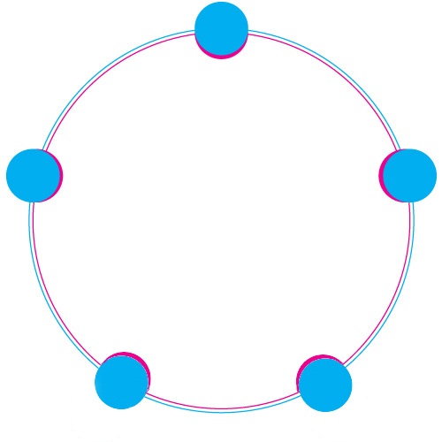

by redrill do they mean literally drill the 5x114 pattern ontop of the 5x112?
If so, I personally would pass just because it sorta looks cheap having that many holes in your wheels, and if they're "re-drilling" I dont see how that wouldnt be visible. companies like xxr or rota usually do that to appeal to both patterns.

Omarg. Yeah that was my thinking too. However they all promise me that the redrill will not be visible in any way. The redrill is so close that the bolts basically cover the original holes and the redrilled portion. In fact one vendor says that it's common for some places not to even tell the customer that a redrill was done because they would never know the difference.

Here is an image of what the redrill would look like. Pink is current hole, blue is the redrilled part.

I had my wheels re-drilled and have not had any problems, I just need to get them refinished

If you're set on those particular wheels and only available in the smaller pattern not much else you can do, just be sure to use tight bore adapters if you go w/ the redrill.
