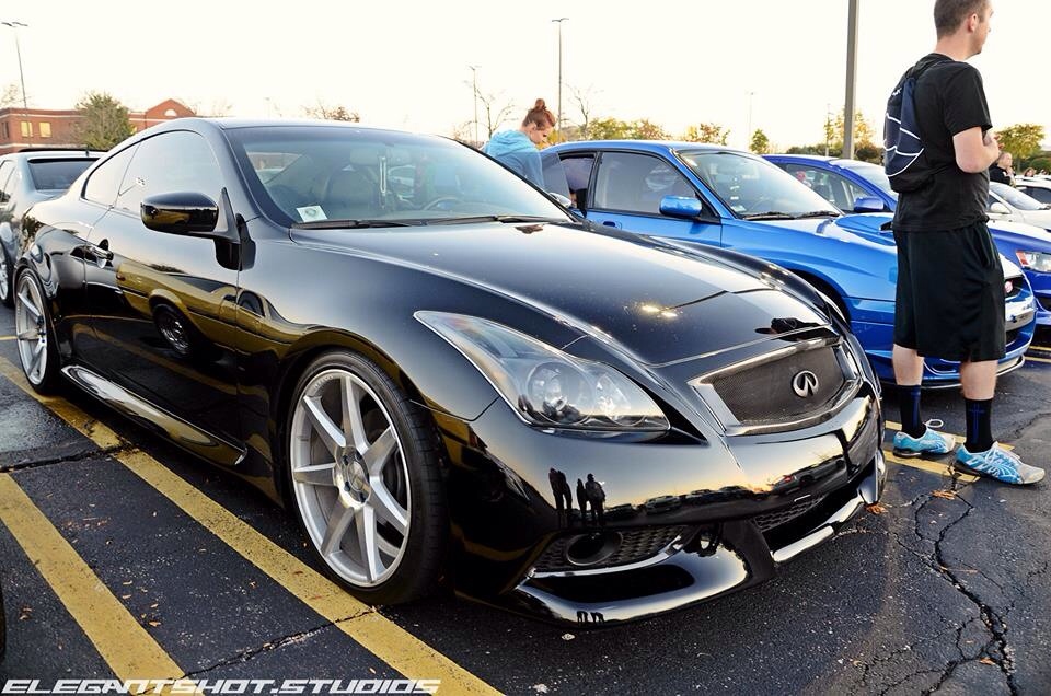

Ok guys ive searched and searched but havent really found a very definitive answer to my question. Currently im running a set of staggered Vossen CV7s on my x coupe but im really considering going with a more aggressive squared setup because of my awd. I really like the Forgestar F14s. But my question is, will 20x10.5 with like a 255/30 or 265/30 all around with say a 25-30 offset have good fitment? Also, would these specs work with any wheel, not just the concave? I know a bunch of people run dual concave with their Vossens so im assuming it should work just the same with the deep concave f14s right? Id just like to make sure the wheels would be all good before I ordered. Im lowered on BC coils and heres a pic of my ride height for reference. Sorry if this confuses anyone because I sort of confused my self writting it! If you guys have any suggestions on tire sizes and offsets, I've got an open ear! Any help is much appreciated!Name:  55D7E222-37F7-4484-855A-D07C4FB7322F-6936-0000026086E9B599_zps22004938.jpg

Personally, I love those wheels. Especially on a black G37
I think that's one of the best designs for your car and I wouldn't change a thing. But if you want something more aggressive, why not PM one of the wheel vendors on here?
