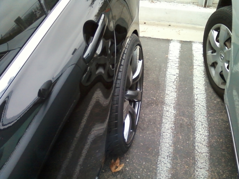

UPDATE:
Here's a pic of the neg camber -3.4 in the rear. The pic is terrible, but the wheels stick out JUST a little. A lot less then before, though.
Coilovers will be installed soon. Can't take the rubbing anymore. Only happens when there is weight in the rear or if I am going up a hill with a bend, but I live on the top of a hill with a bend so its annoying. It was a lot worse prior to the negative camber, but still exists.
Looking forward to the ample adjust-ability of the coilovers. Going broke!
It appears the fenders are sitting on the tires but they're not. There is a small finger gap.

Can you take a side picture? I'd like to see it from the side view. Thanks.

You sure seem to be trying hard to make these GTR rims work on the G37 Sedan. I respect the effort, and like the wheel design. Perhaps seeing it in person is a different perspective, but from these pictures it seems an inescapable conclusion, that these wheels simply don't work on this car.
Who here hasn't had that WTF Moment, driving behind a car with its rims sticking out?
If you're in a happy place, that's all that matters. And perhaps you're a better man than I am, OP.

Worth the effort to me. I love the wheels and couldn't be happier with the look, they suit the car very well IMO. Matter of fact, I was driving home during my lunch break today and a lady in a G37s coupe followed me and flagged me down at a light and was in shock when she saw my car. She told me "Your wheels look really nice, I'm jealous."
People look and then look again when I drive around town (that isn't the reason I got them). With time and some modifications they will work for the car.
I will take another shot when I get the opportunity, but when your looking at the car from any perspective the wheels don't appear to be sticking out like everyone thinks from this thread. Granted, they did stick out a fair amount before I got an alignment. Maybe it really is something that has to be seen in person to understand.
If you were driving behind me or aside me you wouldn't have that "WTF moment," it looks normal. Not trying to convince you to love the look; to each their own.

Looks like you're 95% there , a bit more of a drop and they should tuck right in (but just barely, lol). I'm trying to remember the sequence of events~
I was dropped on B&G springs which slammed the car (about 1/2" of tire under the front fender lip, and just a bit higher in the back).
I then bought the coilovers and adjusted them to zero gap and then purchased the staggered wheel/tire set. Only had rubbing the first couple days, it was real minor on the fender liner and only under severe compression. The area where it was rubbing has worn enough that it's fine now, and just a bit of abrasion on the liner.
I think you'll have to cut your fender liner about an inch from the edge, for about the top 3rd of your fender well, like the 11 o'clock to 1 o'clock area if you're looking directly from the side of the car. There's also a metal fender bracket that seems to give people trouble although I've never had an issue, it seems to be more of an issue w/ coupes.
My wheels are pretty flush but still a few mm room, I think you'll only have maybe 2mm to spare once you lower it a bit more. Here's my rear tire fit for reference.
I'm going to do this tonight! I can hear the wheels hit the liner when going over big bumps. That should get me 96.5 % there, lol. Hopefully she will be sitting pretty after some coilovers! I don't expect that it will be as flush as your car, but I'm okay with that. As long as it doesn't rub.
