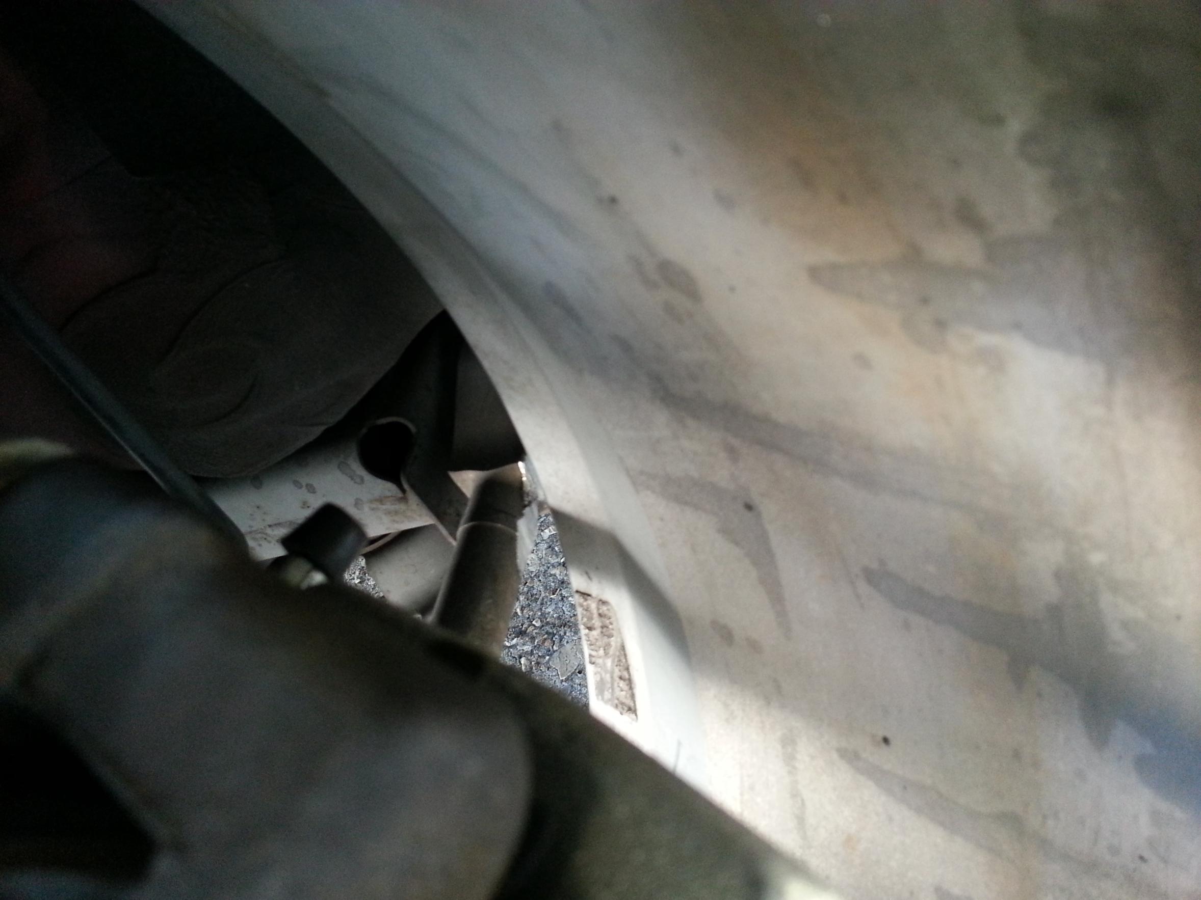

Took these pics idk if it'll help, its just weird that it rubs when lowered but this is the nee current height with no rub so far
OK, it does sound like an offset issue, or possibly an improperly installed suspension arm, and if it's hitting the wheel I would keep it parked and use another vehicle until you can get it addressed. Good luck, hopefully some pics or more info on the wheels will help.
Attached Thumbnails Lowered, Wheel rub in rear-img_20130905_111608.jpg   Lowered, Wheel rub in rear-img_20130902_190749.jpg

Damn, looks like it's been rubbing quite a while
Offsets are typically stamped on the inside of the wheel and it will sometimes be listed as ET +45 for example. A spacer should help, but it appears those offsets are really high. A spacer will esentially lower your offset (making it less positive), you can get them as small as 5mm all the way up to 35mm. With the amount of steel missing on your radial arm you're probably going to need at least a 10mm spacer. Just go 10mm out from your rim and see if that's going to work for you. Also if you can provide the width of the rim and the tire sizes you're running that would help. Like I mentioned previously, please don't drive it like that, rent a car if you have to

it actually wasn't rubbing that long maybe 15 mins was the total drive with a few heavy dips in between, it's just looks this bad on this side (passenger) because my friend was sitting in the back on this side the driver side is barely noticable, but it's been fine the past few days since i readjusted everything with the preload and correct strut height(checked the clearance and looks normal about a little more than 1/4 inch) but i think i'll also just get a small spacer , but for whoever asked the rear tires are 265 35 20, and i think it's 9.5 front and 10 rear, i'll keep you guys posted thanks again for the help

Glad to hear it's been OK lately, I'd go ahead and order a new radial arm though, I'm still curious about your offsets so if you're able to check the inside of one of your back rims it should be in there, post it up if you can.
