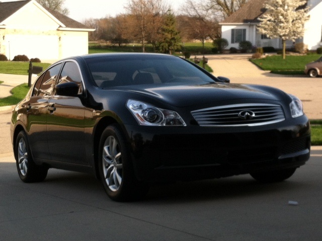

Here are the tires 245/50/zr17. General G-Max 03's on my 2009 G37x. I like the look and it handles a lot tighter but keeps a relatively smooth ride

Without a question the new tires make a visual and I'm sure a handling difference. Nice upgrade.
