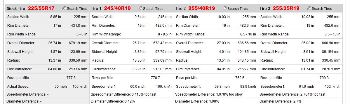

To the OP, keep in mind, going wider (tires) will reduce your mpg too, even more so if that rubber is high performance sticky summer tires. If this is not a concern, disregard this comment. Just something to keep in mind.
Stock size on your car was 225/55/17 (all season) I believe. Going to a 245/40/19 will keep the speedo error to practically none. 255 is an odd size, though 255/40/19 would still keep the speedo error < 3%
