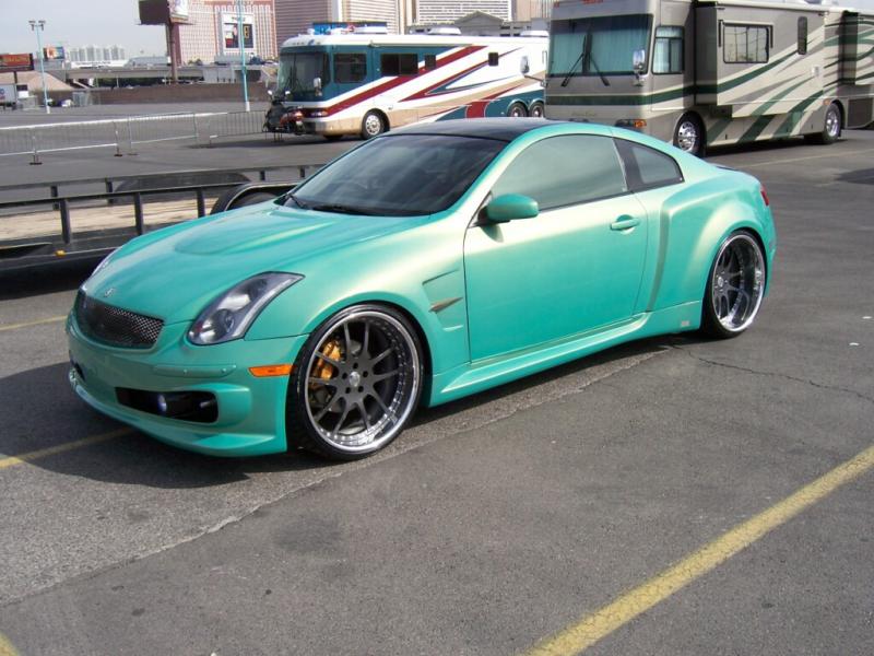

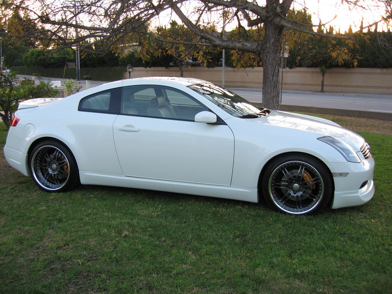

Sorry ahead of time for being clueless on offsets, fitment, etc. Looking to get some rims but have noticed that everyone gets different sizes. Is there a consensus on what size to go with? Are there any noticeable differences in ride quality or performance when going with either 19's or 20's? I am looking to get 20's and do know that I'd like a "deep dish" look. In addition, if I plan to lower the car, what would I need to know to make sure I get the correct size of rims and tires. Wanted to get some info from you all so that I have some sort of idea what to expect. Any suggestions or recommendations would be appreciated. Below are the rims I like: IForged Evolution Anthracite and IForged Daytona Anthracite. BTW...which rims look better?

19's are lighter and a little better for performace but 20's just look hot. I would recomend either 19 or 20X9 and 19 or 20X10.5 with offsets for the rear no lower than 35 but no higher than 40 for them to go on without rubbing and/or camber adjustment.
