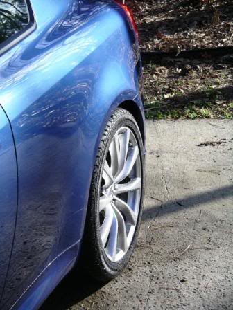

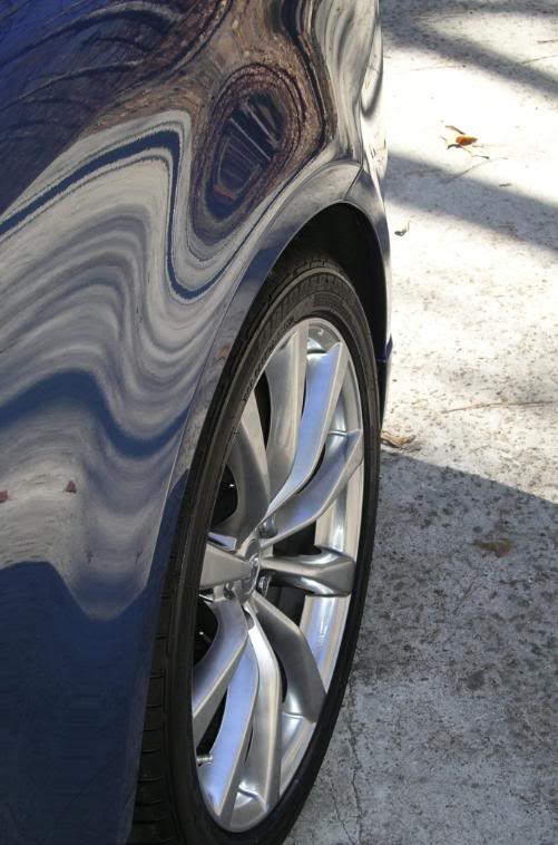

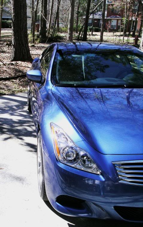

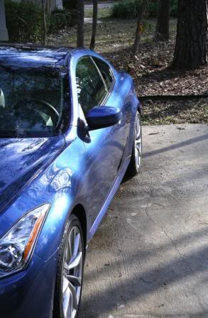

I posted some pictures in the media section early on after I went to 245/40/19 Potenza RE050a Runflats up front and then 275/35/19 Potenza RE050a Runflats in back. At that time I also was playing around with some wheel spacers to get a slightly more finished look. (Even with the wider tires things were a little deeper under the fenders than I was looking for). I had used some cheap eBay spacers that I wasn't happy with, but have now moved to a nicer, hub centric version.
I recently "invested" in a set of Eibach pro spacers; 10mm rear and 5mm front and thought I would post some shots. These spacers are designed for the 350z or similar 114x5 wheels, and work fine on the rear, but the fronts have a small stud on the brake hub than prevents these particular spacers from going on. I need to put the spacers for the front in a drill press and drill out the hole nearest this stud so they will fit, once I do this I will post pictures of the front and finshed product. I also have just ordered some stillen sway bars which will complete my suspension/ wheel-tire mods for now.
STock rear tire
Rear with 275 RFT installed
rear w/ 275 tires and 10mm spacer
Left side after rear spacers
