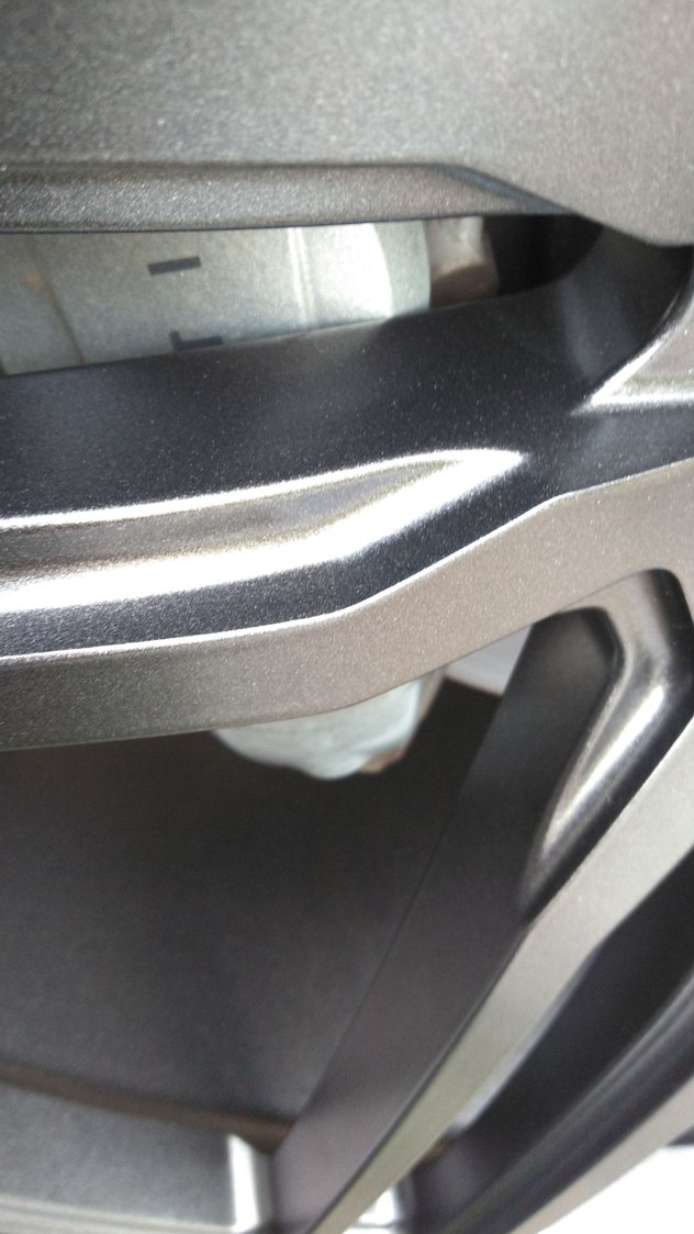

I ordered them and I get a call a few days later. They said these wheels might rub the front brake caliper due to the concave design. Wheelmax ended up shipping one wheel so I can test fit it and today the wheel came in and sure enough, it rubs the front brake caliper by centimeters. I really like these wheels and I want to make it work. Would spacers be an option or should I just send the wheel back and keep looking?

5 mm spacer may be enough, maybe 10 mm hub centric and extended studs to be safe.

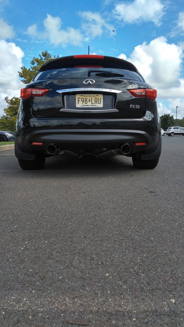

Old Sep 20, 2020 | 12:12 PM

All you need now are some lowering springs and thinner spacers up front, in my humble opinion, and maybe some chrome lug nuts.

I dunno if I can go any thinner up front, they barely clear the brake caliper now. Maybe bigger spacers in the rear?

How big are the front spacers? To me it just doesn't look right when the wheels extend past the fender. Dead even or ever so slightly in is perfect.

The spacers are 10mm all around
