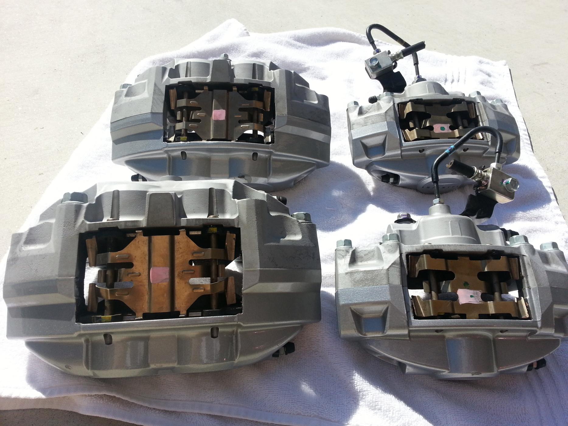

Is it just me or all four of the calipers are for the passenger side only?
hahahahahaha YUP!! Someone Got screwed at the Junkyard.
Sorry bro I didn't get screwed just posted the wrong pic but that was a good catch!
