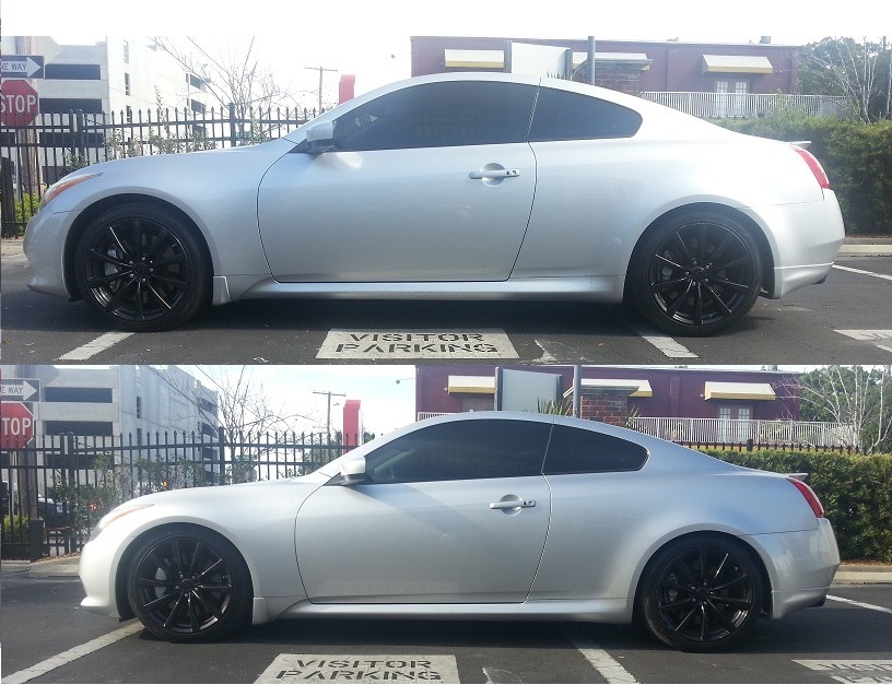

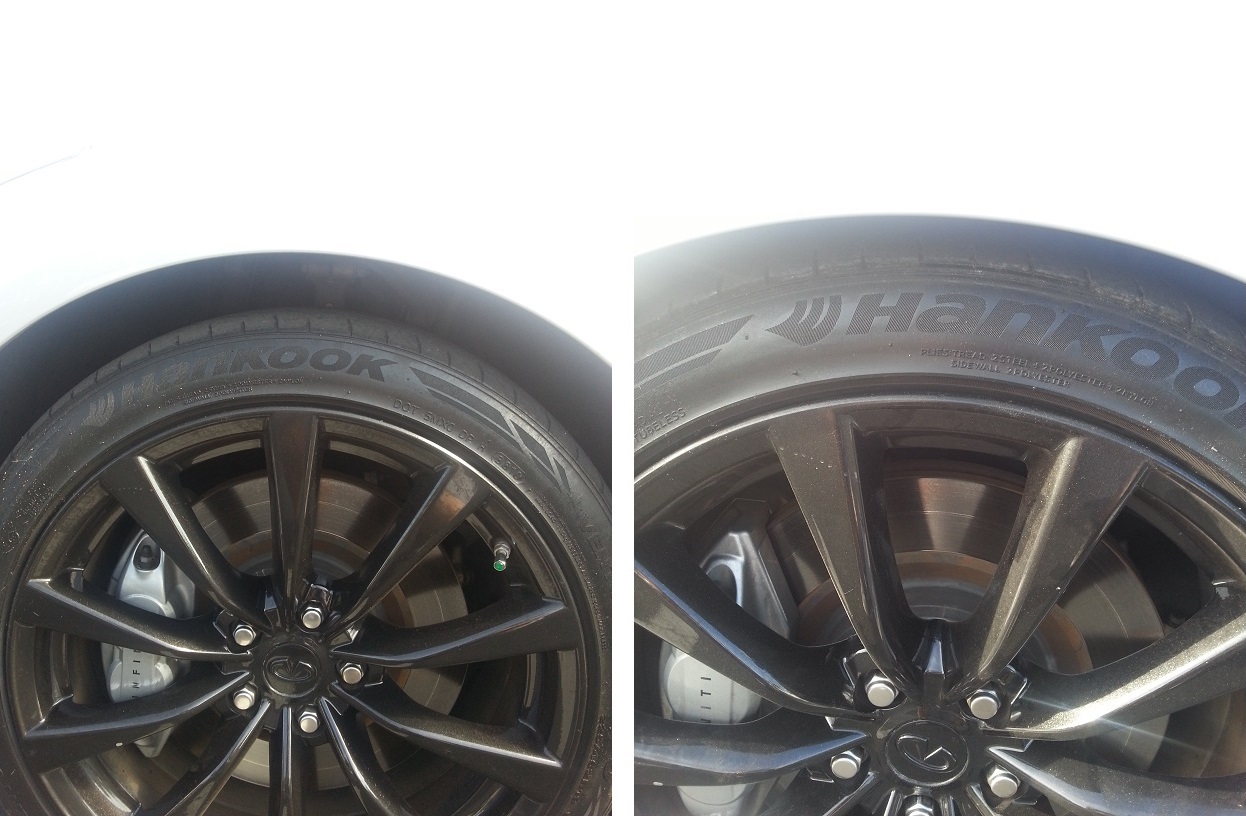

Finally got the courage to go for a drop! Always been a little skeptical cause of flooding here in Tampa and having to be cautious about parking blocks/speed bumps/pot holes etc, but figured what the hell! This is about an hour after install, but there was a large difference immediately. pictures almost don't do it justice. I was so surprised how big a difference getting lowered by only about an inch makes when looking at the wheel gap in person. Should have done this a long time ago lol.
Ride quality feel ever so slightly... more firm. I don't think it feels necessarily stiffer but when i went over the speed bumps in my association the car feels more planted to the ground and i don't feel like i get popped up out of my seat. Also noticed I can feel more of the road when going over small cracks or hitting those recessed light things in the lines on the highway, not that it is uncomfortable - but I'm definitely more aware of riding over stuff.
Overall I'm super stoked about how the front closed up and how driving feels slightly sportier. I have a feeling I might be a little lower than the 1.2/0.8 eibach labels for the pro-kit, since I'm already just about that now immediately after install.... but after a week I'll take a pic, measure and compare again to see if it settles more, if at all.

Anyway, the pics ain't that great (angles of wheel gap, sunlight etc) but I definitely thought it was lower than expected... I went out and measured this afternoon and the front was 26.2" and rear was 26.4" after 1 day of settling, and there is nothing in the car to weigh it down, and little less than 1/2 tank of gas. the wheel gap closed slightly more. yesterday i was able to get 2 fingers in F&R (index/middle) now I can only fit my thumb (lil bigger than middle). I need something like this for my girl too
From what I've searched and read in the lowering database thread this is decently lower than most other eibach owners.... starting to get a little worried about alignment now, definitely was trying to avoid $500+ for the camber kits

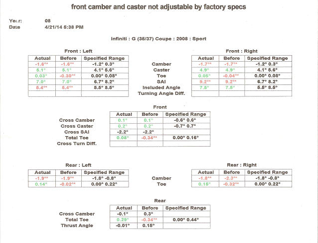

Just got an "Alignment". I only know as much about alignment as what I've goggled for about an hour, but it looks like the camber up front is decently out of spec and the SAI/IA are significatnly different up front - not sure if this is a big deal or if it balances out but I was shocked to see over a 2* difference between right and left. The back doesn't seem bad.
I feel like I just wasted $90 for them to only adjust the toe bolts, which yes im glad my wheels are pointing strait... but pretty sure they didn't even check my steer wheel to see if it was strait (not that it matters, but it should be done! lol)... plus the $20 I spent at the bar across the street while waiting.
edit; anyone have insight to the SAI/IA angles being significantly different up front?
