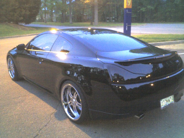

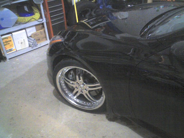

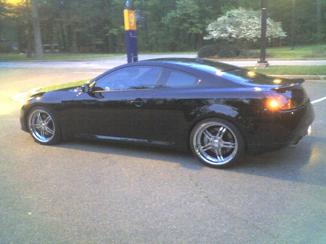

I finally got my wheels in..

very nice! what are the specs? did you have to run spacers?

looks good!! any specs?

Mako: Nice wheels. Are those pics w/o the springs in the rear or with? I know you said you took them off the back.
So, now that you cut the trim are you still rubbing?

What offsets are you running? are you using a spacer? Man, now I really can't wait for my R55's to come in....geezus!!!! Looks great man!!!

did you drop the car?

Yeah the rear springs are on in this pic (tanabe drop), I had to take them off the first day until I seen what was rubbing in the fender well, so i could cut it out.. The specs on the wheels. 25mm offset all the way around, I have a 5mil spacer in the front. Simple set up 20/8.5 front, 20/10 rear, 245/35 front tire, 275/30 in the rear.. The rear had a little rubbing until i trimmed about 1/4 out of the felt material, and trimmed where the rear bumper met the fender, about 1/4 inch on the corner.. Had to order hubcentric spacers for the front cause i have a little vibration in the front end.. Hopefully they get here soon.. All in all I'm happy!
