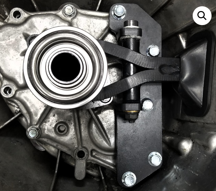

Originally Posted by RobC7
I really hope you went with the CMAK the second time around.
No I didn't.
With the CMAK, the throwout bearing fork doesn't have a rubber boot and there is an ~1" x 1/2" opening in the side of the transmission.
With the salt brine used on the roads, I would like the bell housing sealed as much as possible.
The next time, I will be putting in a JWT heavy duty CSC.

Originally Posted by SonicVQ
No I didn't.
I wouldn't worry about it however they come with a rubber boot now.
That's good to know!
Pic from their site:

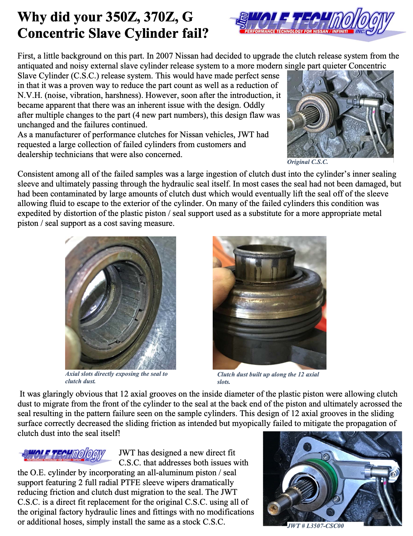

Sonic, RJM has been making this claim for years: "Reduces or Eliminates OEM Slave & CSC Failures on these cars."
Is it true? But I like to think it is, if only for peace of mind. When my CSC blew out 7 years ago, it was under warranty and I had them replace it with OEM, but I also bought the RJM assembly shortly after.
If I remember correctly, their theory was the CSC being "over extended" . JWT has a different theory:
I'll figure it out when it fails again

That's good reading from JWT. I'd not seen that before. Sure would be interesting to get RJM's take on that opinion.
