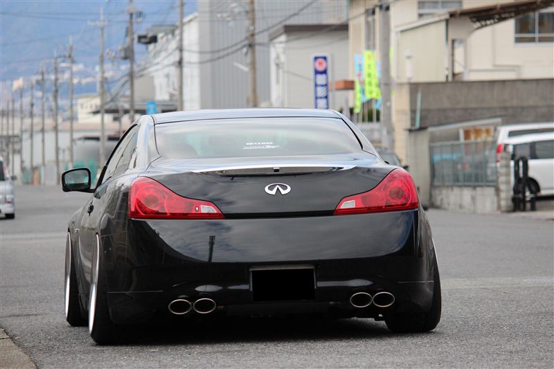

In short, every day terms: high offset (something like +40) means the wheel will be more "sunk in" while low offset (around +20 and below) will be closer to the fender or poking out past the fender.
Visual of high offset:
Low offset:

Thank you SOOOOO Much for the visual!! I prefer a flushed or sunken in look! I don't want the Low Offset...
