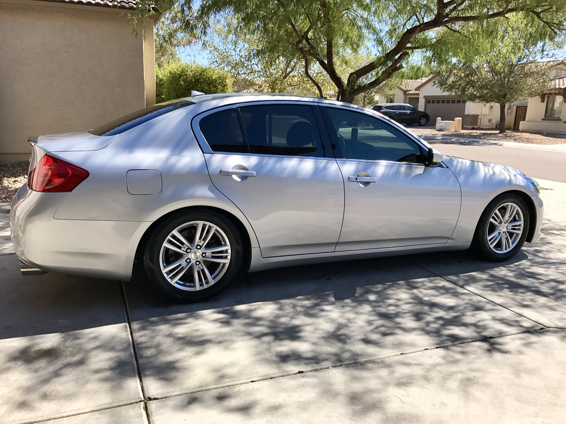

Here's my rwd sedan on swift

Swift springs are fantastic. I've had them for years and the ride quality does not deteriorate, if you think about it that doesn't even make logical sense. Do OEM or other springs' ride quality get worse over time? No, they don't. What could happen is that cheap people put shorter stiffer springs on a car without upgrading or even replacing their 60K mile OEM dampers and it accelerates their demise. That is a possibility that could cause ride quality to get worse. I installed my Swift springs along with a set of Koni yellow adjustable dampers and the ride is great (sportier than stock but not the slightest bit harsh or jarring) and has been for several years. They are a mild drop that fixes fender gap but leaves the car at a very manageable daily driver height. I can recommend this setup as being better than the vast majority of coilovers IMO other than the higher end more expensive sets. I took coilovers off of the car for the Swift/Koni setup and haven't looked back. I can confidently recommend this route as a cheaper and better (IMO) setup for what you want. The quality of the springs and dampers in most coilover sets isn't particularly very good.
However, I have RWD, not an X. Also, I don't have to deal with any winter issues as it is 81 degrees F here on Christmas Eve where I live.

My setup that I referred to is Swift springs on all 4 corners, and Koni struts in front, shocks in the back. I opted to go with the sedan application on a coupe because the spring rates are slightly softer for the sedan. Sedan and coupe suspension parts are interchangeable, at least on RWD cars. Don't know about AWD.
