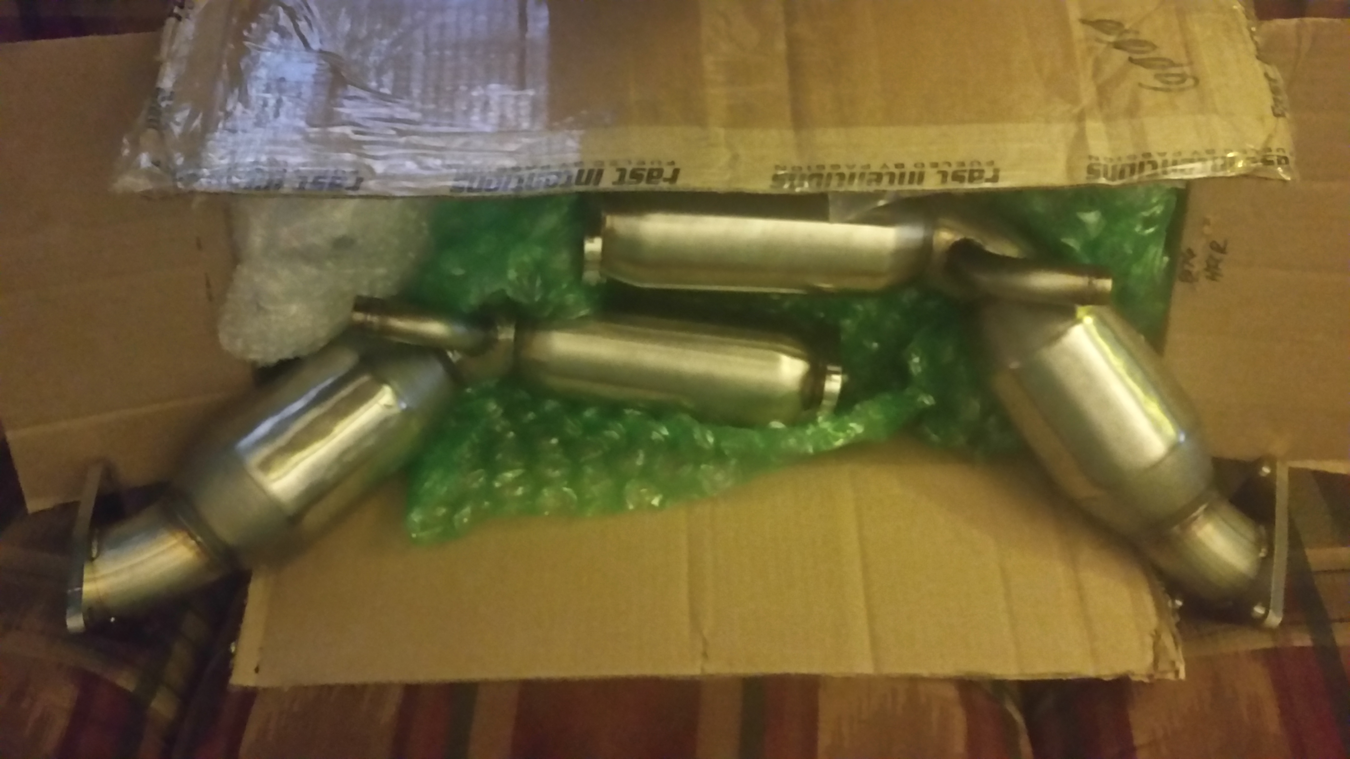

Look what was on my doorstep when I got home!

Old Feb 17, 2017 | 06:33 PM
Likes: 4,952
Nice^^^How long was it from order to arrival?
Old Feb 17, 2017 | 06:44 PM
The Pope's Avatar
The Pope
Joined: Dec 2016
Posts: 477
Likes: 80
From: Garner, N.C.
One Day!
(I found them on Ebay. Less than 50 miles away. Never been installed!)

That's an impressive find, OP. There's a whole thing out there, of people who buy parts but for whatever reason can't bring themselves to have the work done.

I'm planning on installing the FI-HFRCs today and when done, my first drive will be to get a Lottery Ticket! :-)
Thanks for the link Roch! I'll see what I can design while I'm under the car today. Ideally a bolt on solution. (I do mechanical design for a living.) :-)

5The original CATs are out!
One location on each CAT is held to the header via a bolt that comes from the engine side through the header flange and threats into the CAT. The only one of these that gave me trouble was the one on the driver's side. I got it to backoff a 1/4 turn but no more. So I just snapped the head off. (and no, I didn't use my impact gun, just the guns that God gave me) ;-)
So with ruffly a hour and a half in, the original CATs are out and I'm taking a break for lunch.
It's all installed! Going to get myself cleaned up, do an ECU Reset and take it for a spin! :-)
All is GOOD! No Cells thrown!
