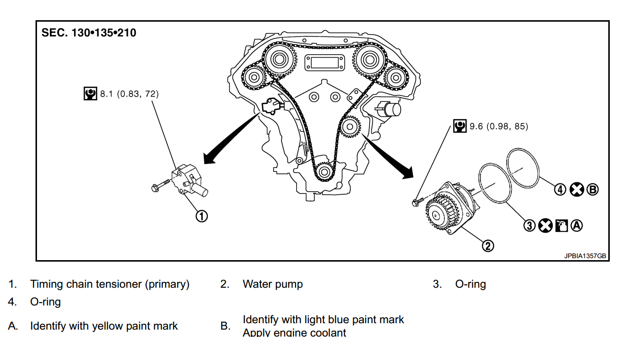

Perhaps the OP misinterpreted his mechanic. Based on the FSM, the mechanic is partially correct. Major disassembly is involved in replacing the water pump. It's driven by the timing chain and is located behind the timing chain cover.
From the pics below, I really don't see this part failing any time soon.

It's actually a pretty ingenious design. Many cars still use external pumps these days (belt or electrically driven). I'm sure each design has its pros/cons. Really though, what is there to fail other than the seals.
I suppose if you ever need a timing chain/guides replaced, doing the pump at the same time is wise.
