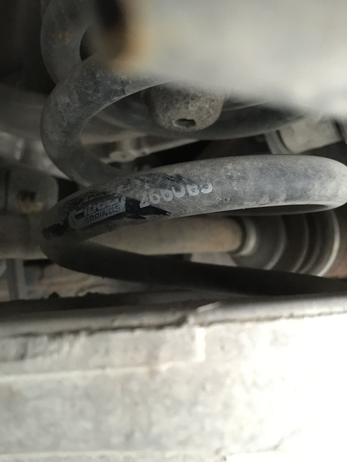

Not sure what drop is in the back but here's the spring
Old Feb 18, 2016 | 03:18 PM
That's a pretty mild Eibach drop but still in the 1.5" range and a rear camber kit would be a good idea. As far as doing something irreversible, as long as the
toe slot is elongated per the template that is included you can still go back to your original bolts if you need to later on. The hole isn't bigger, it's wider and the new bolts are the same thickness, they are just mounted further outside on the sliding washer so you have a wider range of movement, this is what gets your toe in spec. The 2 bolt kit also works for the rear camber arms, this gives the OEM camber arms more adjustment range.

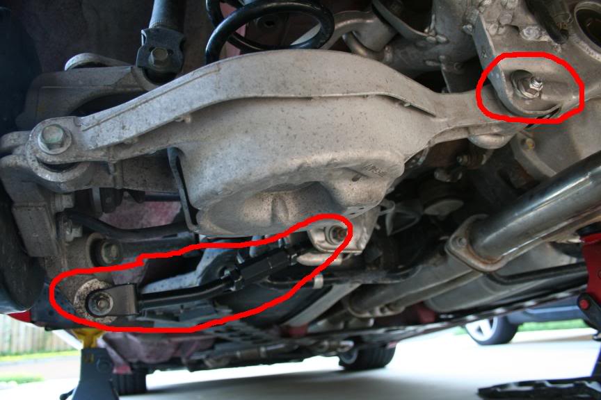

Here's a pic that shows what they do, the camber arm in this pic is an SPC adjustable arm, but the bolt holding it down (to the right of the arm) is what slot you would elongate along w/ the toe slot in the center

As far as that noise in your front shock, your OEM shocks are probably on their way out, so going w/ coilovers or a new set of dampers is probably a good idea, and some coilovers (not all) should have enough adjustment that you could go a bit higher than you are now. The Tein Basis coilovers are a good choice for a mild drop coilover, and they're a good price at about $600.

Thx for the info! Ya I'm pretty sure I'm gonna get the tein flex z coilovers. I found them for around $900 and I don't think u can go wrong with tein. So that 2 bolt kit your talking about, that's to the right of the arm like u said right? I didn't know there was two sets like u have circled! Do you also have to elongate the hole with them? I'm probably just gonna try to get by without the camber kit but maybe some new bolts. Even if they're OEM just cuz mine are a lil rusty lol.

The single circle pic is the toe adjust bolt, the long oval circle the single bolt on the right is the camber adjust bolt, you would need to elongate both bolt holes on each side if you want w/ the toe & camber bolt kit and toi get camber AND toe in spec.. At the very minimum I'd get at least the rear toe bolt kit. You'll need to get the toe in check or you will shred tires in a hurry. The front toe is fully adjustable w/ the tie rods so you're ok there.
