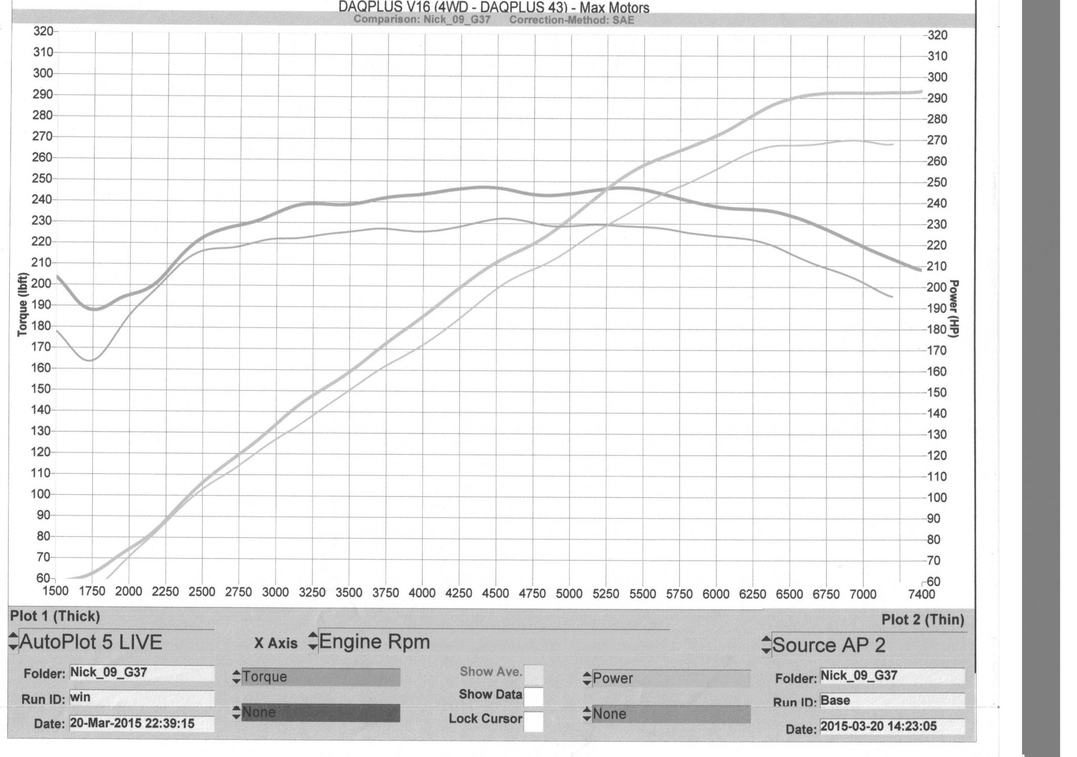

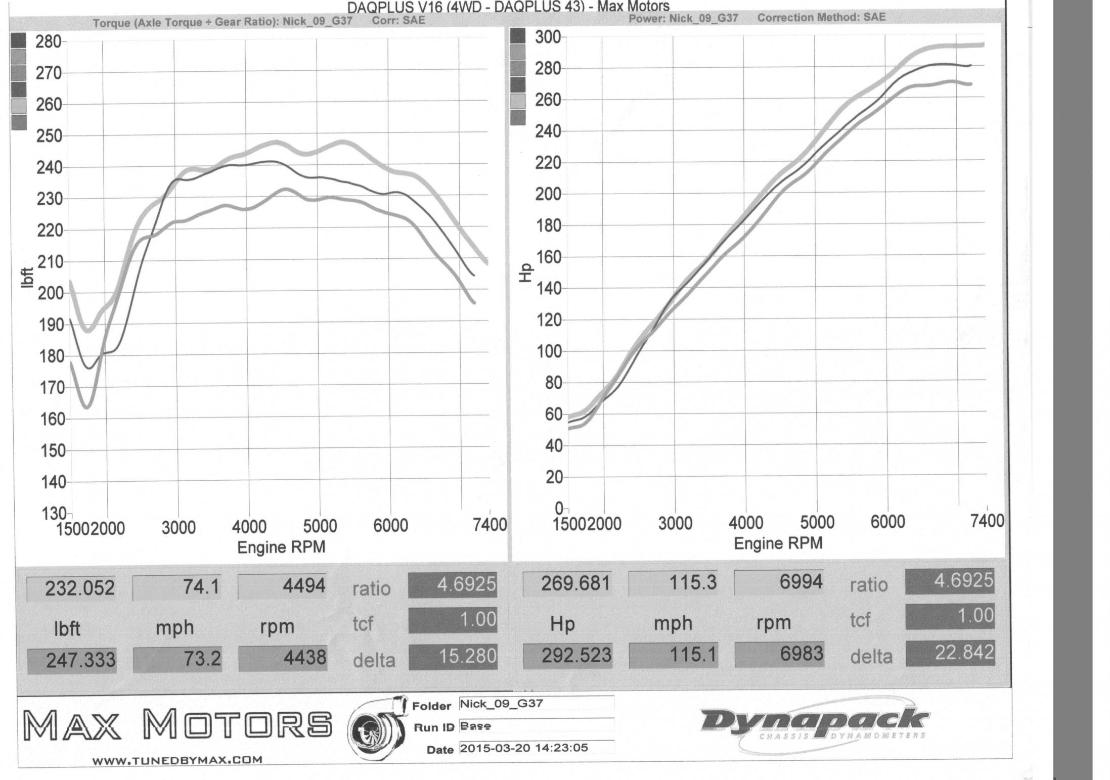

Dyno results
I was hoping to push over 300, but this is decent. Talking to the shop about TT next. Going to get the ball rolling on that relatively soon. I can definitely feel the torque increase. Pulls a bit harder in the mid range. Sounds very mean too. Only downside to the ARk exhaust is that is sits so freaking low! Like incredibly low... Probably a good 4-6 inches below the lowest stock part on my car. In hindsight, I should have went with FI. ARk also didn't come with the gaskets that go between their cats and the stock exhaust manifold. The shop I took it to had to make them. There were also several dents in the exhaust. I'll be emailing them about this. Wasn't very happy overall with ARK. Sounds great, but the exhaust looks bulky and goofy when looking at the rear of the car for how low it sits. Coupled with the problems stated above.

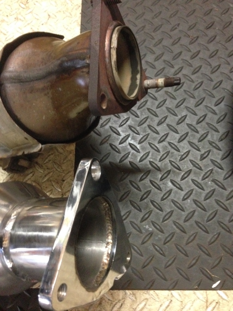

Strong NO. I've been emailing ARK about the concerns stated above and feel I am being given the middle finger. Poor customer service from their end. I'll go in to a bit greater detail about my entire experience.
Parts came quick. In a week or so. I ordered the R-spec cats and the GRiP exhaust. Two large cardboard boxes that seemed in perfect condition. Opened them up to reveal each part individually wrapped in foam paper and taped well. My plan was to put them in backseat and open them when I got to the shop to preserve them as best as possible. I opened one cat (as it was a small part) just to make sure everything was good. It looked clean, welds were solid, no scratches or dent so I assumed everything was good. I went to the shop and had my stock exhaust + cats removed which was a PAIN. Started install at the cats and worked way back. First thing I noticed, missing gaskets that attach cats to stock exhaust manifold (see attached). My mechanic had to drive to 3 different parts stores to find material that would work. Then had to fabricate custom gaskets, and I'm not even sure if they will hold as it was not the optimal material to use. I called ARK to ask about this, the rep seemed irritated that I called him and was very blunt with me. Assured the stock gaskets would work. Adamantly insisted they would work. I even had the shop owner on the phone with him explaining the differences. As seen from photo, the stock gasket is a metal donut that fits around that lip on the flange. The R-spec is flush. No way it would work. Ok, fine. More money and time and frustration. Then I opened the other packages when it was time. As soon as I opened the packages I noticed several large dents with scratches around them. At this point, I am pretty irritated with ARK. I took pictures of EVERYTHING and documented it very well to send to them later on. I wasn't going to halt the process and bundle everything back up to send back to them. I am already 3-4 hours into the process and having to pay for labor and missing parts at this point. After install, the fitment was so poor. The left side was hanging lower by about 2 inches that the right. My mechanic had to bend some brackets to get it to fit right. This was AFTER we loosened and tightened and loosened and tightened for an hour, trying to make it line up. It still looks shoddy. After the fact, the exhaust hangs LOW. very low. It looks bulky and clustered from the rear (reminds me of a cheap honda fart can). You can find similar statements from ark owners of the height of the exhaust. The exhaust is blatantly obvious if viewing the vehicle from the rear and looks tacky and cheap. I scraped on a small driveway 2 days post install that I should not have scraped on. I emailed ARK with all the details of my experience. I provided photos, side by side comparison, etc. They basically gave me the "That's too bad" speel. I know they're a sponsor of this site, but come on. I paid over $2000 for this setup and I had problems from the get go. I honestly think my parts were used at one point due to the damages that were on them. I wills say, the packaging was good! There is no way THAT AMOUNT of damage could be instilled on that piping from shipping. You would have to throw the packages off the top of the semi multiple times to cause that kind of damage. Not impressed at all. The sound is great, but that is the ONLY thing I like about this exhaust, everything else is bad. I should have done a bit more research before I bought. By the way, this is my review, so please don't flame me and say, "You're an idiot I had a good experience." etc etc. This is my personal experience with this company and I am giving my honest review.

Thanks for posting. Decent gains.
Glad I decided to pass on the Ark. Hangs too low + isn't much louder than stock. So for the HP gains, it sounds like it definitely isn't worth it.
