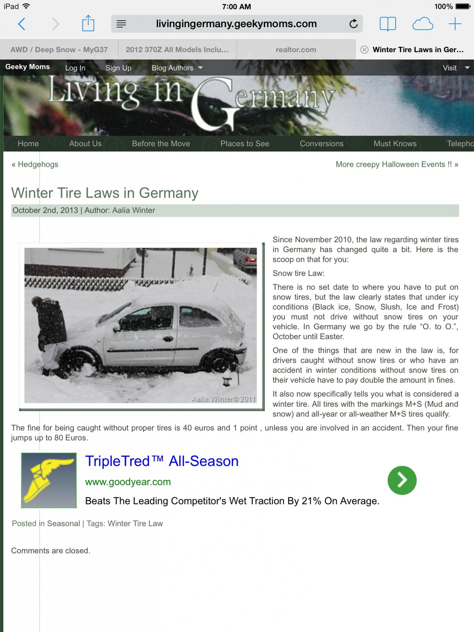

Edit. Yes I'm correct. You need a snow tire. The conti DWS counts since it has a snow symble but not a lot of a/s tires have that so youre very limited in selection. So just buy snows and be don't with it. Keeps summer tires lasting longer too. Pic was written in 8/13 as you can see.

I apologize but you are not correct, your article even supports my statement. All season tires are legal. The only requirement is they have the M+S branding. Many all season tires have the M+S branding, denoting "Mud and Snow", the OE tires on the G37x included. Snow tires are denoted by a snowflake (not M+S), the Conti DWS do not have a snowflake because they are not snow tires. They are a good set of ALL SEASON tires, and they are legal in Germany, because snow tires are not a legal requirement. The minimum legal requirement in Germany is M+S branded all season tires with legal tread.
Your opinion is that snow tires are best, and that's fine, but the fact is that snow tires are not a legal requirement in Germany, which you were claiming was the case.
