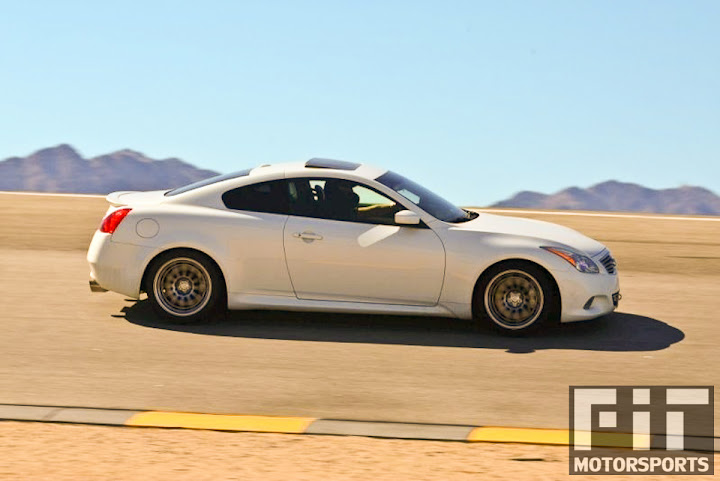

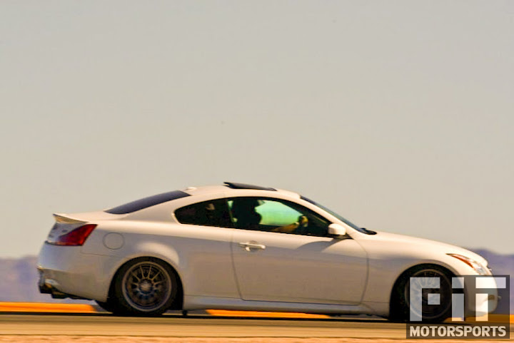

Pics of Brake Ducts @ CVR by Fit Motorsports
Now equipped with Brake Ducts, no brake fade and tons of fun.

Nice pics, how did you do compared to the other cars there ?

i like, can i see what they look like inside the fender
I did not time myself, so don't know how I did compared to other cars. But even with ceramic Hawk Pads no fade.

are those 18" wheels? what brand/model?
outside wheels look reallllly small in that fender when turning.
Old Nov 8, 2012 | 04:17 PM
joo030879's Avatar
joo030879
Joined: Sep 2009
Posts: 445
From: 94129
Enkei NT03+M
18x9.5 +27 Front (now +22, running 5mm spacers to clear Akebonos)
18x10.5 +30 Rear
-1" either very expensive Racing Compound for 19" Wheels. Most tire makers don't make 19" Tires using racing Compound. Yeah a lot of body roll with RS3's.

Hawk hps pads? What was ambient temp? Finally, how did you run the ducting and do you have pics of that?

Originally Posted by ashmostro
Hawk hps pads?
Hawk makes three different brake pad compound.
1.HPS which is street pads good for street use.
2.Ceramic less noise and dust if you want to keep your wheels clean.
3.HP+ which is for hard driving with minor track use.
+-75 degrees
No I don't have pictures of duct. However I made a hole on Wheel Skirt and ran duct behind the front suspension. +-6 foot of duct on each side.
Good work!
Thanks
